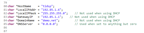

We are trying to run a sample client program provided in MCSDK under ti\mcsdk_bios_3_01_04_07\examples\ndk\client with setting the board in DSP no boot mode.
We are not able to get any prints in the console. Could anyone please exlain what this sample application does? what should be the IP configurations given in the Client.c file ?
Basically what we are trying to do is we need to test socket communication between K2L Board and Host(pc), we found from the forum that we need to use sample ndk applications for K2L Board.we successfully compiled the application but we do not know what should be the behaviour of this application,currently we do not see any console messages , kindly let us know step by step procedure to run a sample ndk application.

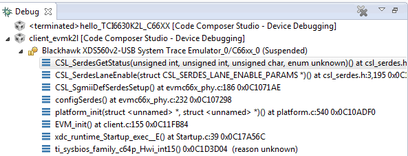

  • Hi Titus,
    Thanks for the reply. Actually our code is not stopping at main() and we are not able to see the prints in CCS console.
    We checked the call stack and the program is stuck in one function.
    I am pasting the call stack here.
    Please provide a way to resolve this so that I can proceed further.

  • Dear Kushal,
    It seems to be known issue.
    This issue has been fixed in our latest Processor SDK release and you are using MCSDK.
    www.ti.com/.../PROCESSOR-SDK-K2L
    software-dl.ti.com/.../index_FDS.html
    Otherwise, you can comment out the "void CSL_SgmiiDefSerdesSetup()" entire function and use the following function and then rebuild the platform project.
    K2L platform project:
    C:\ti\pdk_keystone2_3_01_04_07\packages\ti\platform\evmk2l\platform_lib
    Import the above project and rebuild with mentioned change.
    C:\ti\pdk_keystone2_3_01_04_07\packages\ti\platform\evmk2l\platform_lib\src\evmc66x_phy.c

  • Hi Titus,
    I have tried building the new platform package that you have mentioned. It is still not going to main().
    Stuck at CSL_SGMII_getStatus() at csl_cpssgmiiAux.h
    Kushal
