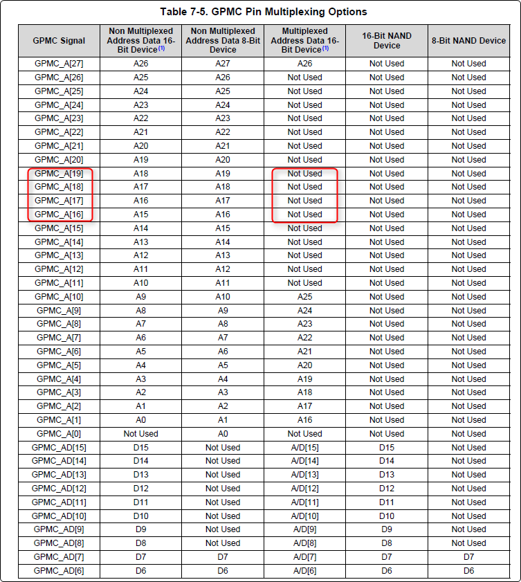

We have an AM3354 ZCZ package and are configured for multiplexed A/D connected to a FPGA. We have not been successful getting the high address signals to toggle with the rest of the Multiplexed A/D bus signals.
Based on the peripherals we need in our design, the only high address signals available via the Pinmux Tool were on the LCD_DATA(15:12) signal pins (T5, V4, V3, and V2).  The Pinmux Tool output shows we have the LCD_DATA(15:12) pins set to Mode 1 while the Multiplexed A/D bus is set to Mode 0.
Note: The cloud based Pinmux Tool did not work because it needed a pinmux.h file which we couldn't find on the TI website so we used the old Pinmux Tool.
Can someone please review the attached Pinmux Tool output?
