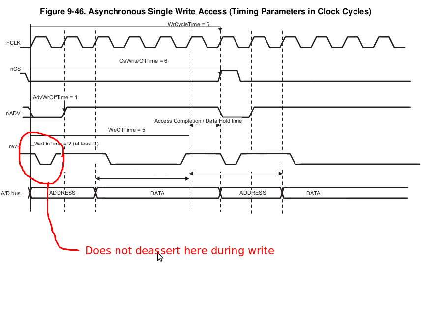

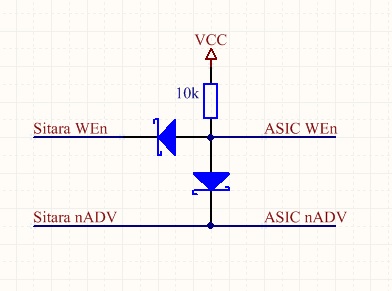

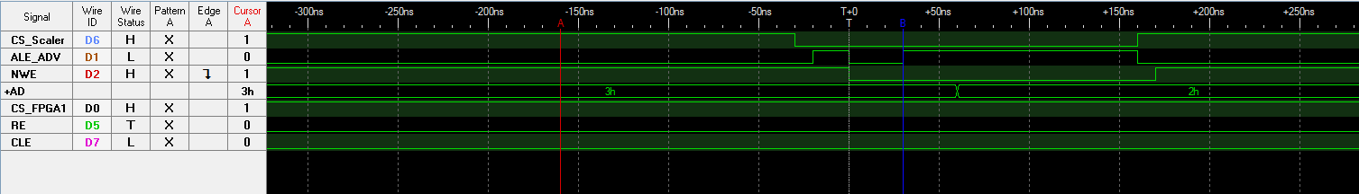

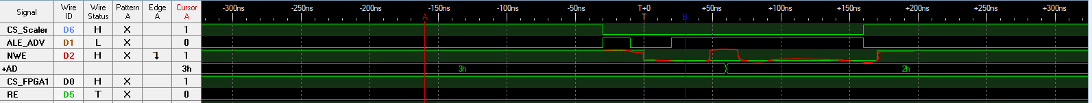

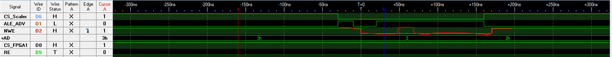

I am currently trying to implement GPMC pus as a parallel interface In my am4379 custom board. I have connected the cs3 to the external asic. the gpmc bus is 16 bits wide and the device is a 8 bit device in address data multiplexed mode. my write enable does not deassert for address write section. I am trying to access the chip in asynchronous single read and write mode. I have memory mapped the peripheral and i could see the chip select pins going low when i try to access that mapped region. below are the timing diagram for the chip i am trying to communicate with. and the device tree settings.

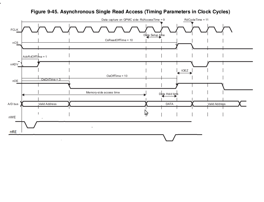

my expected timing diagram for read and write access:
My problem:
Any suggestions on what i might be doing wrong here? The timing diagrams n the trm for GPMC none of them match to the timings needed to communicate to my chip. Any further advice will be greatly appreciated. Regards
