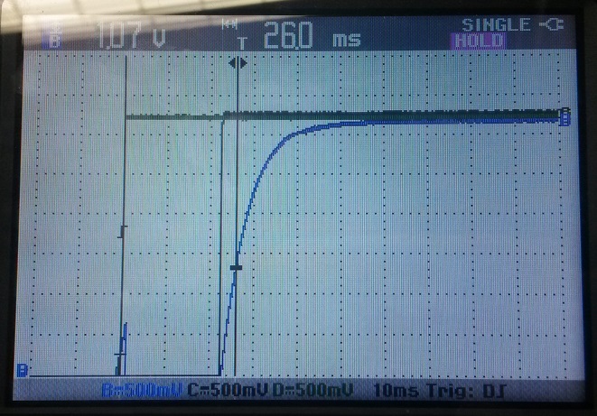

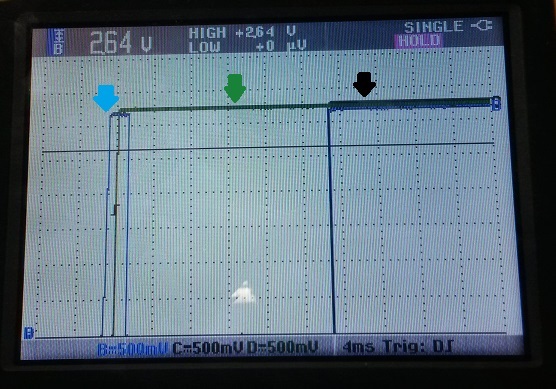

We have a instability on detection of Ethernet PHYs with wrong behavior of RJ-45 led indicators.
Bellow we collect some messages from Linux startup and the Device tree configuration for validation
a) Below we have the messages from Linux startup during a process of wrong detection

[ 26.626634] net eth0: initializing cpsw version 1.12 (0)
[ 26.635634] net eth0: phy found : id is : 0x7c0f1
[ 26.641209] net eth0: phy 4a101000.mdio:01 not found on slave 1

    a) All schematics of our board are with TI team (we sent by e-mail)
    b) This problem is not deterministic. All boards mounted show this problem and appear to happen just with a power up cycle (not with reboot). Some boards need more cycles interation to review the problem than others.
    We fell maybe there is a issue with our Device Tree creating a instability on MDIO.
    Can you point us to some direction?
    ROFINO
  • Could also post if you want to use the interface in switch mode or dual mac mode? Also please post the complete boot log, we need to see if the MDIO driver is able to communicate with both PHYs.
  • We wanto to use it in switch mode.

    TEST WITHOUT HARDWARE RESET SIGNAL
    We made a test, open the circuit between pin A10 from AM3352 and the pin 19 of LAN8710 (RESET). So, we have now no hardware signal connected to the PHYs. We made measurement on LAN8710 and we saw the correct high voltage presence, assuming that way, the PHYs don´t have hardware reset enabled.
    On first impression, we thought that without hardware reset the PHYs won´t be discovered. After all, the datasheet of PHY says "A hardware reset (nRST assertion) is required following power-up." But,  what we have now is 78% (14 test/ 3 error) success discoverability of PHY when our software correct boot. So, we are assuming that the reset of PHYs are software controlled.
    a) Is possible to use these PHY just with this approach (without hardware reset signal)?
    b) Something more you can share about instability of PHY discoverability of LAN8710 without hw/reset?
    NOTE:
    We probe three signals:
    a)     N_RESET_INOUT(A10) : blue
    b)     VDD_3V3B (PMIC LDO4): green
    c)     PMIC_GOOD (PGOOD connected with PORZ/B15): black
    We saw that N_RESET_INOUT make a glitch before PORZ and close to LDO4 PMIC power on (maybe just a coincidence). Anyway, the behavior of N_RESET_INOUT is incorrect. Below, we found this information about TI notification on BBB site and the related workaround: "Based on notification from TI, in random instances there could be a glitch in the SYS_RESETn signal from the processor where the SYS_RESETn signal was taken high for a momentary amount of time before it was supposed to. To prevent this, the signal was ORed with the PORZn (Power On reset)".

     Using reset signal, we were successful 70%. Looking at signal probes, we saw a timming between power-on and reset deassertion with 22,9ms (below 25 ms specified for the component). So, we are operating out of specification. Note the glitch change their shape.
    TEST WITH HARDWARE RESET SIGNAL and CAPACITOR
    We repeat the same approach from BBB using a capacitor to ground in the line of reset. But this is a circuit not recommended by Microchip. Anyway, we use this solution and now we have the signal reset working inside the specification. Note the diference of glitch shape. The rate of success is 100% (powering the board with AC). We will extend the test with USB power.
    I´m not appreciate this kind of solution. Seems to be very empirical for me because with a capacitor with larger capacitance I saw error in PHY detection. So, we need to work with capacitor value between 1uF and 2,2 uF and not aligned with Microchip best practices.

  • NEW ANALYSIS DIRECTION
    We found a correlation between PHY Discoverability and PMIC battery charger (we use a 1100mAh LiPo battery):
    a) We did not found PHY Discoverbaility error with PMIC battery charger OFF (both AC and USB power)
    b) We did not found PHY Discoverbaility error with PMIC battery charger ON or OFF (only USB power)
    c) We found PHY Discoverbaility error with PMIC battery charger ON (only AC power)
    We started actions looking for the behaviour with AC power. We found difference between AC and USB BOOTLOADER PMIC configuration sequence.
    We equalized the both code sequences for the same of USB program and we are testing.
