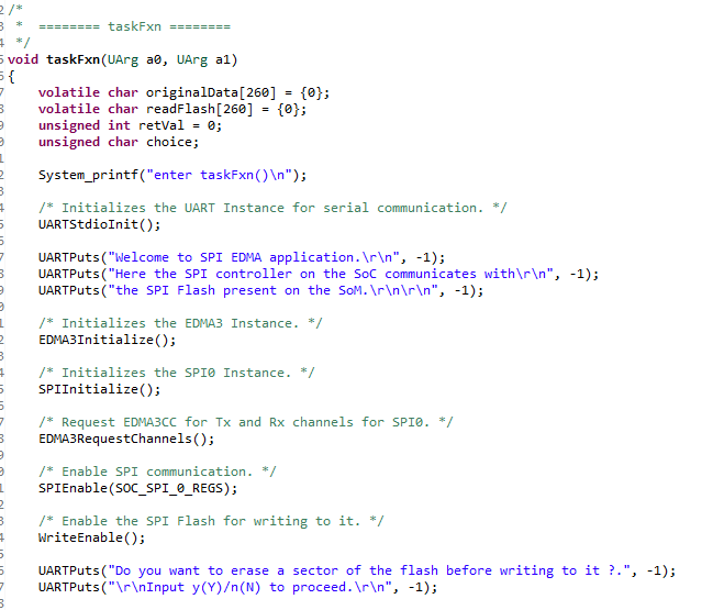

I copied over all variables, functions etc., and I'm running the core of the example in the task that gets created by the default sys/bios typical example:
most of the example seems to be working correctly. I can break inside edma3cc isr, the spi is triggering the edma interrupt.
The error, to my humble opinion, is a caching or memory issue.

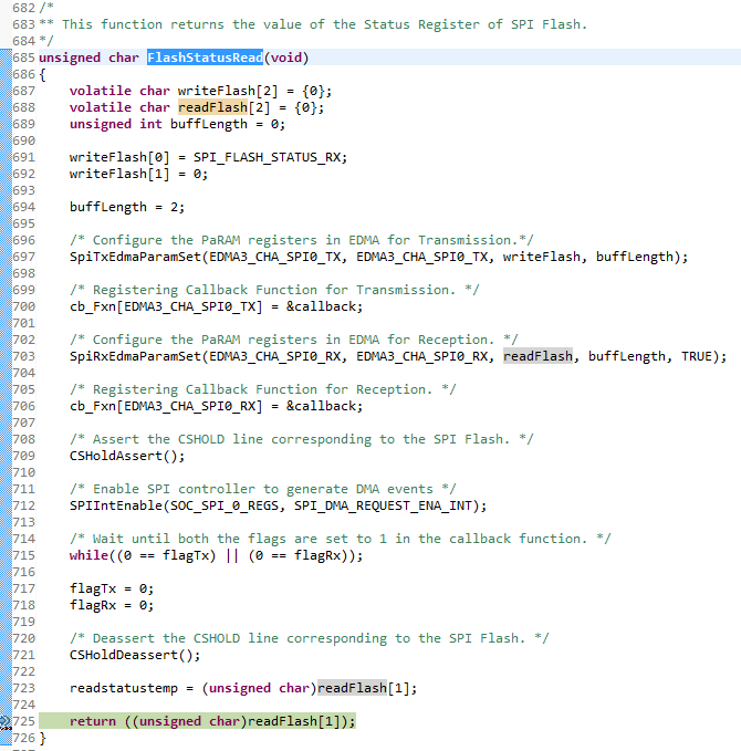

Inside the WriteEnable function there is a call to check if, in fact, Write is Enabled.
/* Reading the Status Register of SPI Flash. */
temp = FlashStatusRead();

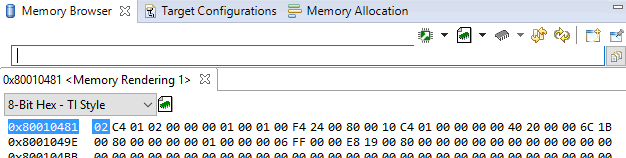

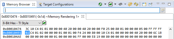

readFlash[1] is suppose to be 0x02.
The strange part is that the location in memory has the expected value:
if I use the memory browser and go to
but the return value is = 0x00.

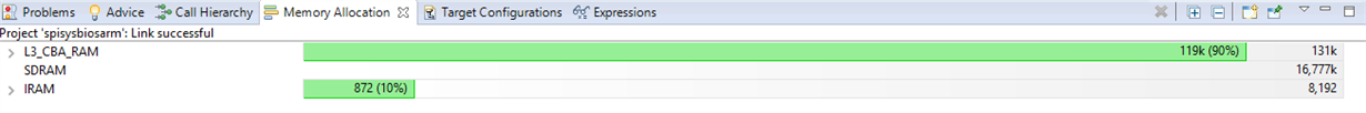

and created a custom platform where all the code ends up in SHRAM.
