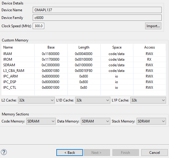

I have two projects for the omapl137. One on the DSP and one on the ARM side. I've created my own IPC (just a simple shared memory location) where the DSP and ARM communicate.
I created 3 memory segments:
IPC...
I have configured them as io (assuming this will disable caching). A very similar platform is created for the ARM side. My code only runs if I call: Cache_wb and Cache_inv accordingly in the right places.
I don't have a need for this memory segments to be cached and have tried the following with the intent of disabling cache:
  1. set L2, L1D, and L1P Cache to 0
  2. remove cache module from sys/bios
My question:
  1. How, if possible, do I disable caching for a section of the shared memory on both the arm and the dsp in sys/bios?

    May be, there would be an option to put the shared region in external memory and make change the MAR bit for that particular region to be non-cacheable.
    You have privilege to control whether the external memory addresses are cacheable or non-cacheable through Memory attribute register (MAR) bits (0 = noncacheable, 1 = cacheable). The memory attribute registers are documented in TMS320C674x DSP Megamodule Reference Guide (SPRUFK5). You shall enable caching for the external memory through CSL function CACHE_enableCaching. For more details. please refer Section 2.3 in the c674x cache user guide doc. as mentioned below:
    May be, you shall check all possible cache configurations for C674x devices with 2048K bytes in the c674x DSP cache user guide as given below:
    http://www.ti.com/lit/ug/sprug82a/sprug82a.pdf
