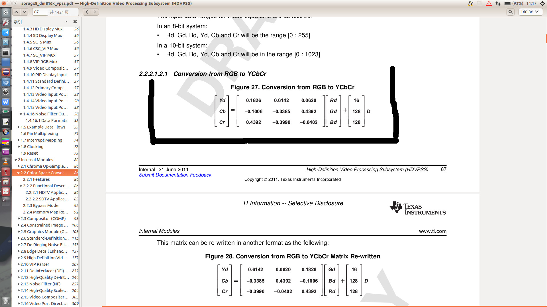

I use dvrrdk 4.1, and i want to set my dvo2 output from level 0~255,not 16~235,
in my application only csc used to convert yuv-->rgb888,
and in hd encoder rgb888-->yuv,
and i use VPS_CSC_MODE_HDTV_GRAPHICS_Y2R instead of VPS_CSC_MODE_HDTV_VIDEO_Y2R,
VPS_CSC_MODE_HDTV_GRAPHICS_R2Y instead of VPS_CSC_MODE_HDTV_VIDEO_R2Y
so i think output range will be 0~255,
actually, it is not what i think,
what is the problem?
i also rewrite convert coeff by myself, it can not output 0~235,
can someone tell me how to configure?
