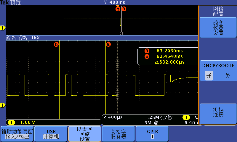

    Step1、Two A8 am3352 boards, Send a set of data(0x1, 0x2, 0x3, 0x4, 0x5, 0x6, 0x7, 0x8, 0x9, 0xa),from MasterA UART1 to SlaveB UART5
    Step2、Operation Process: Board Power down ——————>Board Power Up——————>Send a set of data(0x1, 0x2, 0x3, 0x4, 0x5, 0x6, 0x7, 0x8, 0x9, 0xa) from UART1 to UART5
    Step3、Repeat above Operation . In this process,we found the receive data is not correct .
        1)Step2 ,there is a certain probability , Occurrence of the following conditions:
        First group
            UART1 Send     [0x1, 0x2, 0x3, 0x4, 0x5, 0x6, 0x7, 0x8, 0x9, 0xa]
            UART5 Recv     [0x2, 0x3, 0x4, 0x5, 0x6, 0x7, 0x8, 0x9, 0xa, 0x0]

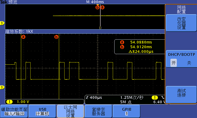

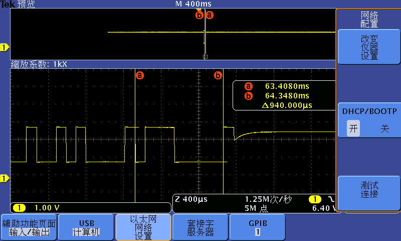

        Problem phenomenon :The set of data is missed the first data,thus tha last data make up by random data.
【Doubts】
    1、According to the catched waveform chart, Data and waveform consistency;
    2、It only occur condition:power down and up
Therefore suspect :before am335x uart's Tx FiFo active,Did not do empty FIFO action ?
Waiting online~

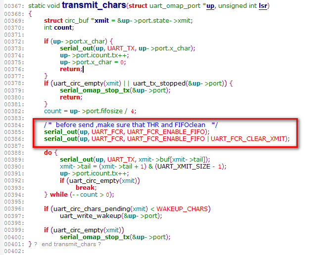

  • Clearing the FIFO is one thing. What I suppose is happening is that there is still data being shifted out from the THR register on the sending side when you shut down. The situation could be the similar on the receiving side. To summarize:
    On the transmit side you must ensure that both transmit fifo AND transmit hold register are empty before shutdown.

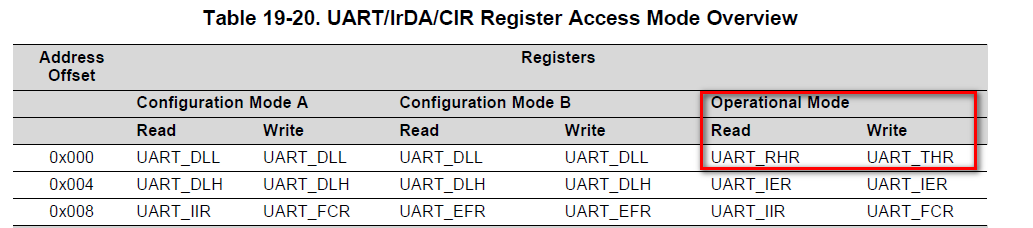

    Still a doubt:
    As UART_RHR offset=0h same with UART_THR.
    When it tranmits over and switch to recive mode, is it influent for UART_RHR that we write UART_THR 0 value?
    References:  spruh73l.pdf
  • These are two separate registers sharing the same address. THR is a write-only register, RHR is a read-only register. In other words, when you write to address offset 0x000 data goes to THR, when you read from 0x000 data comes from RHR.
  • Hi,Biser:
        As your advise:
            To ensure transmit_chars right that we execute the following statement. As shown in the figure :
        The modified code succeed solving the transmit_chars problem during power up and down.

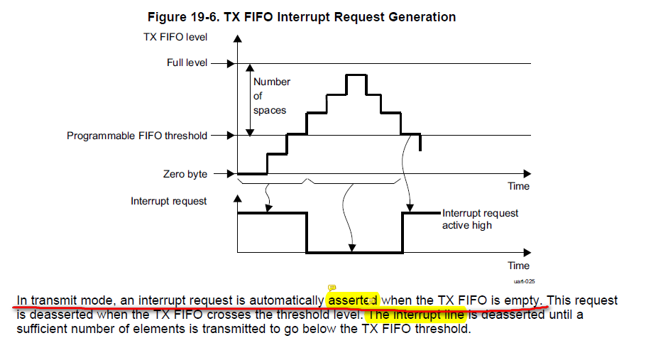

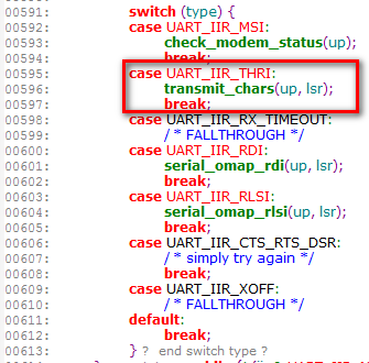

        With IIR_THRI flag setting, as shown below:
        As the datasheet description, is there no risk of modification ?
        As the datasheet description, is there no risk of modification in the transmit_chars ?
  • I don't understand your last question. If the problem is solved what is the issue?
