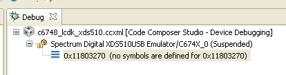

When I traced the ROM bootloader by CCS emulator, it looks copying only the first 784 bytes (or 0x310) of the block even though the block has 0xffa0 bytes length as shown above.
I guess that the ROM bootloader iterates a process that copies some bytes from NAND flash into a scratch memory and again copying that to IRAM, but after copying the first 784 bytes, it doesn't copy the remaining bytes anymore.  I'm afraid I have given up to trace the ROM bootloader because I don't have the bootloader source code. :)
Does anybody know why it happens?  (I also suspect that the AIS image wasn't correctly burned into NAND flash, but I'm afraid I don't have any tool to investigate NAND flash contents.)

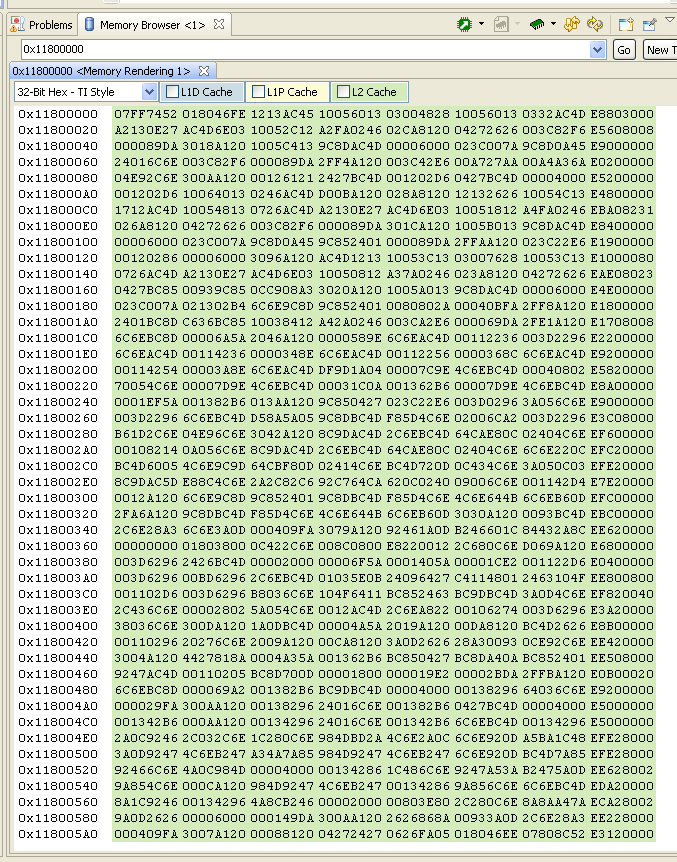

    By the way, after some trials, I found that there might be some address dependency,
    The following is my decoding result of AIS image which did not boot successfully.  It begins with some PLL, PSC and peripheral initialization code which AIS tool automatically generated, and the my own application code follows them.  Exactly speaking, my code is from 0x11800000.
    Section Load Command (addr=0x00800020, size=704 (0x2c0))
    00800020: 02806828 02b40068 9013008c 10938cf7
    00800030: 7246e6a7 0200b2fb daefac05 eb802200
    00800040: 0f673351 6c6e5e8d 0002d60a 1ce61005

    Section Load Command (addr=0x11800000, size=65568 (0x10020))
    11800000: 27773677 86779577 053c35c4 01be54f6
    11800010: 02461347 06000041 043f82d5 e2600300
    11800020: e8e6272e 30010f13 208002a5 270012a9
    11800030: 06267756 268016a8 233c62f4 e2200202
    (snip)
    However, when I moved my application from 0x11800000 to 0x11801000, it became to work as expected.
    My understanding is, the preceding parts of AIS are no more required when loading my own application at 0x11800000.  So it should be okay to overwrite the AIS generated code at 0x00800000.
    May I ask you to confirm if there is some address restriction to put application image?  It shouldn't share address where AIS automatically generated code exist?
    Yokoyama, Atsushi
