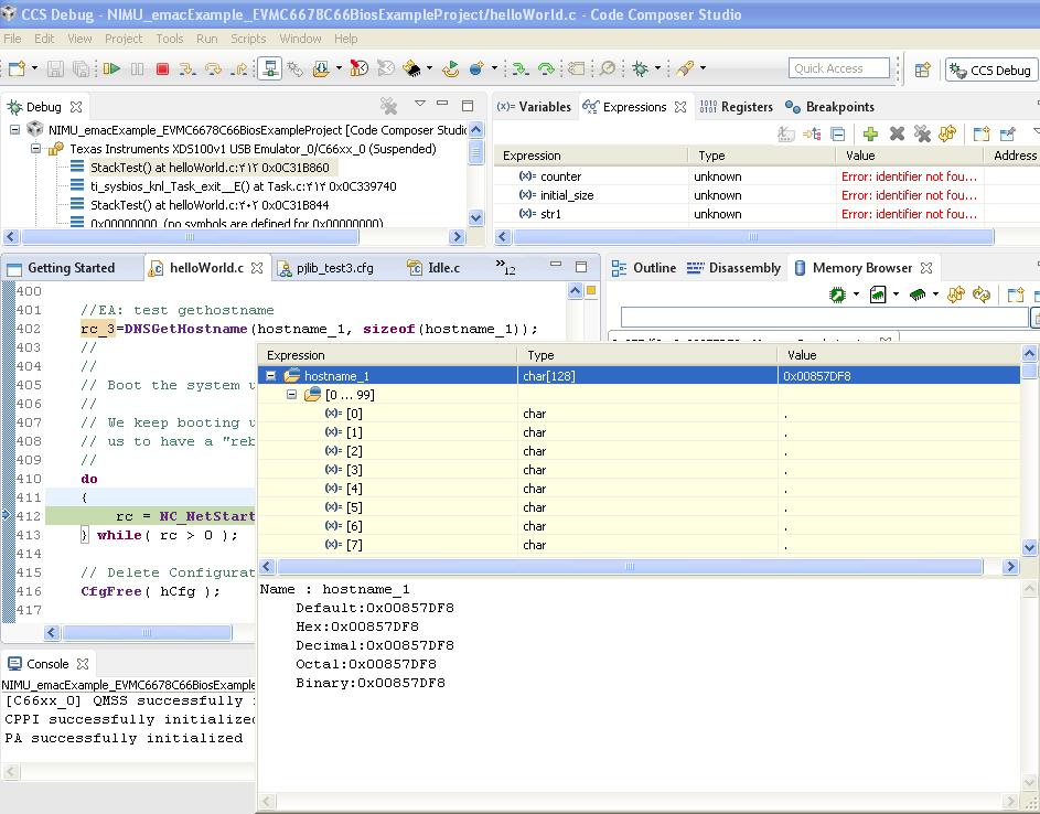

Hi to all
i try to test  DNSGetHostname() in NIMU_emacExample from PDK_c667x_2.0.0 (my device and packages: TMS320c6678  ccs 6.1.2 bios_6_45_01_29 ndk_2_24_03_35)
NDK document said : "This function is quite similar to BSD's gethostname()" and i add DNSGetHostname() before NC_NetStart() :
    char hostname_1[128];
    hostname_1[127] = '\0';
    int rc_3;
    //EA: test gethostname
    rc_3=DNSGetHostname(hostname_1, sizeof(hostname_1));
    // Boot the system using this configuration
    // We keep booting until the function returns 0. This allows
    // us to have a "reboot" command.
    do
        rc = NC_NetStart( hCfg, NetworkOpen, NetworkClose, NetworkIPAddr );
    } while( rc > 0 );
i expect see "tidsp" in hostname_1 ,but buffer is empty and  return value is 0 !
i can't find any example or E2E post about DNSGetHostname . anybody can help me how to use this function?
thanks
Ebi

    some more info:
    this is body of function :
    /* DNSGetHostname */
    /* Requests the hostname which matches the IPHost supplied to SetConfig, */
    /* or uses the first IP address found in the system if SetConfig was */
    /* not supplied with a host address. The hostname is copied into the */
    /* buffer pointed to by 'pNameBuf' with a max size of 'size'. */
    /* NULL terminates the name when space allows. */
    /* Returns 0 if OK, or error code */
    int DNSGetHostname( char *pNameBuf, int size )
        IPN    IPAddr = 0;
        char   *tmpbuf;
        int    errcode;

    and i think value return from this part:
        if( !NtGetPublicHost( &IPAddr, 0, 0 ) )
            if( size > 0 )
                *pNameBuf = 0;
            return(0);
    i check this function separately and see IPAddr is empty although in run time , i can ping EVM ip without problem  !
    thanks
    Ebi
  • Hi  and others
    by create a thread and call NtGetPublicHost() after NC_netStart() , i can get IP correctly but DNSGetHostname() return 19 (NODNSREPLY 19 No DNS server response) .
    i work on this problem and glad to hear your suggestions...
    thanks
    Ebi

  • update:
    more info : i using static ip
    char *HostName    = "tidsp";
    char *LocalIPAddr = "170.170.170.35";//EA: 192.168.1.4 -> 192.168.5.8
    char *LocalIPMask = "255.255.255.0";    // Not used when using DHCP
    char *GatewayIP   = "170.170.170.1";    // Not used when using DHCP EA: 192.168.1.1 -> 192.168.5.1
    char *DomainName  = "demo.net";         // Not used when using DHCP
    char *DNSServer   = "0.0.0.0";          // Used when set to anything but zero
    char *PC_IPAddr = "170.170.170.17";
    i try to add external DNS server to my project by setting the "External DNS server address" in XGConf's "TI-RTOS->Products->NDK->Application Layer->DNS-Module Settings" page .related line in .cfg :
    //Dns.externDnsServIp = "8.8.8.8";
    Dns.externDnsServIp = "170.170.170.1";
    var dns0Params = new Dns.Params();
    dns0Params.IfIdXValid = true;
    dns0Params.mode = 15;
    dns0Params.ResolveIP = true;
    dns0Params.CallByIP = true;
    dns0Params.RestartIPTerm = true;
    var dns0 = Dns.create(dns0Params);
    but DNSGetHostname() return 19 . i attach simple project (modified version of NIMU_emacExample_EVMC6678C66BiosExampleProject ) for reproduct problem.
