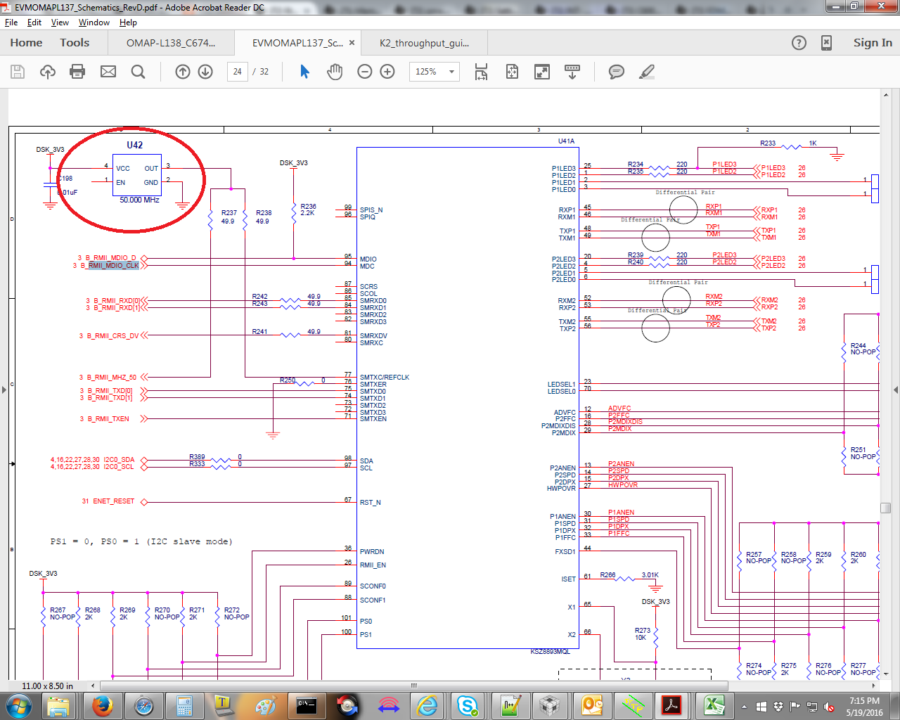

    I think, you can refer OMAPL137 Spectrum digital EVM which is using RMII PHY.
    OMAPL137 (ARM+DSP),AM1707 (ARM) and AM1705 (ARM) are almost same.
    In OMAPL137 EVM, they have used MICREL KSZ8893

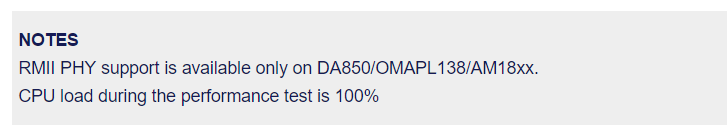

    As I wrote in the first message, I thought that RMII wasn't compatible with this processor because of the note:
    that is shown in the features for the latest PSP for the AM1705 processor at:
    http://processors.wiki.ti.com/index.php/DaVinci_PSP_03.20.00.14_Device_Driver_Features_and_Performance_Guide#Ethernet_Driver

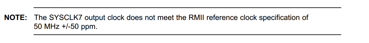

    Please correct me if I'm wrong, but it seems that all the problems related to ethernet interface with these processors is because of the reference clock signal. If the clock is supplied by the AM1705 problems could arise due to the fact that the generated 50 MHz clock is not compliant with the RMII specification, which requires a max freq deviation of +/- 50ppm. This is also true when the clock is generated from the PHY chip.
    This is suggested in the AM1705 literature and in PHY IC's literature as well:
    In page 104 of the Tech Reference Manual SPRUH93B for the AM1705 processor there is a note warning this:
    If we take the for example the Microchip LAN8720a, its datasheet also shows a note describing that if the clock generated from this PHY there could be potential problems as well:
    So in conclusion it seems, that the best alternative (that is, to avoid problems) is to use an external clock generator with the required +/- 50 ppm stability.

  • Dear Patricio Cohen,
    Yes, it seems we should use external clock for RMII.
    I have looked into OMAPL137 schematics which is similar to AM1705, in that, external crystal used for RMII reference clock.
