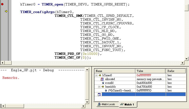

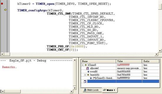

  • Hi, Brad,
    I find my timer 0 handle is not right after calling TIMER_open().
    Please refer to the following:
    Do I miss anything before calling TIMER_open()?
    In my project, I also have timer 1. But the timer 1 handle is correct after calling TIMER_open().
    Really appreciate your help!!
    Eric Fang

  • Dear Sir,
    I already find the root cause and fix the problem.
    In my DSP/BIOS setting, there is a PRD timer using the timer 0.
    I delete the timer 0 PRD timer, and my timer 0 can work normally.
    Just to let you know and thank you for your help!
