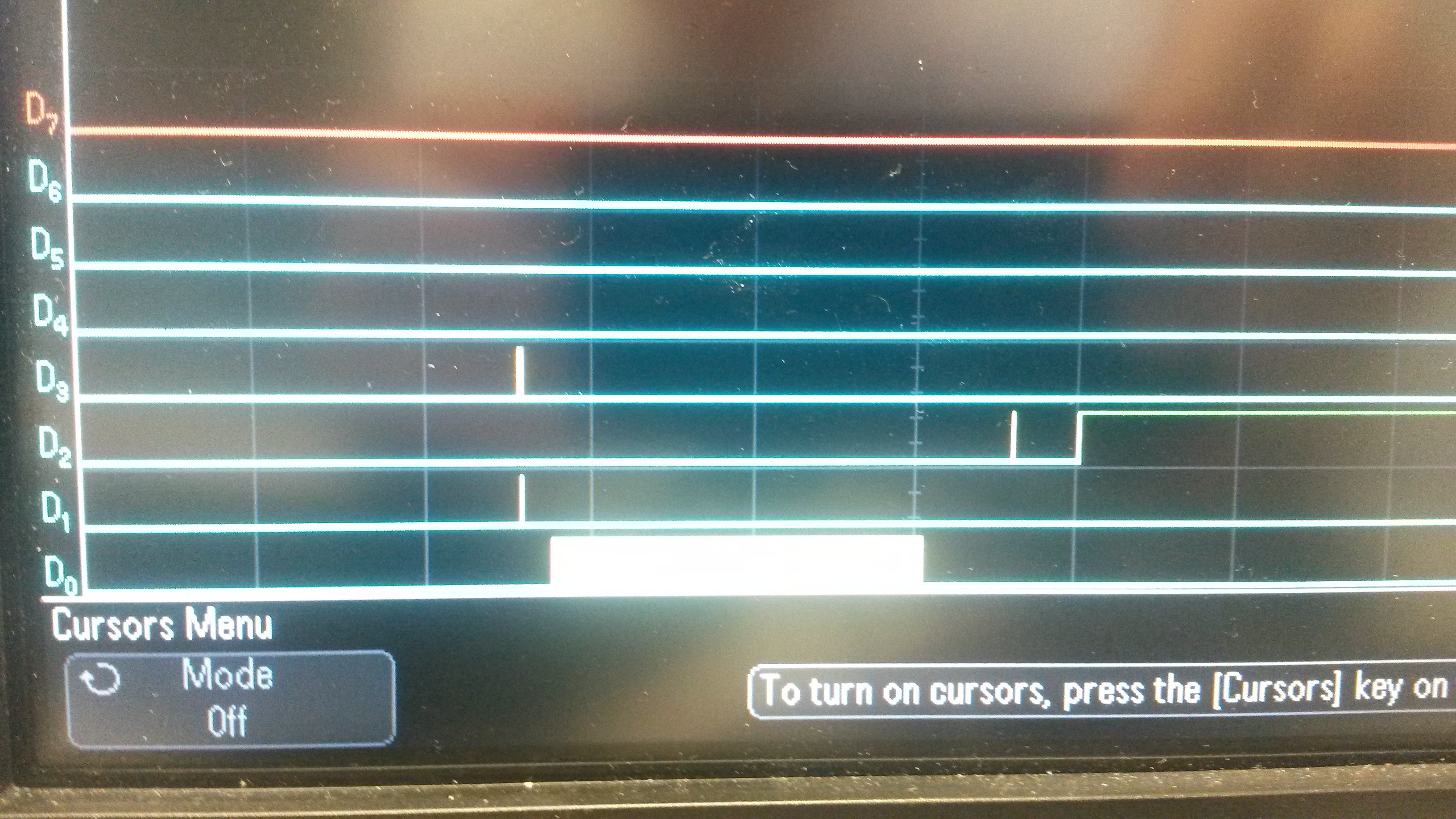

I added a second task to the SimpleBLECentral example project. I use the smartRF06EB with a CC2650 BLE IC. My problem is that the additional task stops running as soon as the main task gets scheduled. Here the code for the additional task:

As you see, the auxiliary task has lower priority compared to the main task. So the main task is allowed to stop the auxiliary task. But as soon as the main task has no more work to do, the auxiliary task should continue running. The auxiliary task does not use a semaphore and it does not register with ICall. Is this an issue?

I connected a logic analyzer to the evaluation board to display the LED status. I see that both tasks get created correctly. The auxiliary task enters the infinite loop (LED1 going high and low many times). But if LED3 goes low (the main task passes ICall_Errno errno = ICall_wait(ICALL_TIMEOUT_FOREVER); ), then the auxiliary tasks gets never scheduled again, even if LED3 goes high again (which is the case if the main task is waiting for work again). What am I doing wrong? I think a stack size of 512 bytes is enough. Here the logic analyzer output:
D0 is connected to LED1, D1 to LED2, D2 to LED3 and D3 to led4.
Predefined symbols:
ICALL_MAX_NUM_TASKS=4
ICALL_MAX_NUM_ENTITIES=7
Both numbers are increased by one as described here: .
Is increasing these nubers really necessary, because my task is a pure RTOS task and has (as far as I know) nothing to do with ICall, right?
Remark: If i switch the task priorities, then the auxiliary task causes starvation of the main task: LED1 is going high and low in an infinite loop that is never left.

  • Found the error:
    In the SimpleBLECentral example project, the function PIN_init(BoardGpioInitTable); is called in main before any tasks get created. So I assumed the PIN driver is ready to use after the initialization. Bu the function PIN_open get called in the main task function. After that call, the auxiliary thread was no more able to modify the GPIO values. When I wrote, that I have a problem with task starvation I was actually wrong. I did juist not use the PIN driver correctly. Moving the function call of PIN_open to main befor I create additional tasks solved the problem.
