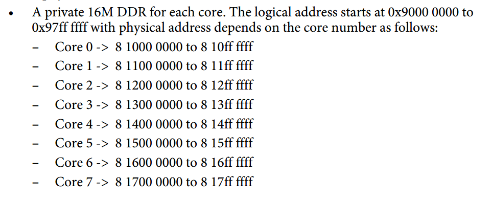

      About  C6678 MPAX,I have some questions as following:
      in the document SPRP820,section 7,there is a usecase as following:
       It is 36 bit physical address,how can I look the physical address's data?in CCS memory browser only can look 32 bit logical address.
       In MPAX_registerDemo,the value of MPAXH is 0x90000017,For core1,the value of MPAXL is 0x8110003;For core2,the value of MPAXL is 0x8120003f.
       After I run MPAX_registerDemo,I find every core can use the address of 0x91000000,B1000000,D1000000,F1000000 to access core1 pravite data,use the address of 0x92000000,B2000000,D2000000,F2000000 to access core 2 private data and so on,why?
      What's the relationship between RADDR and BADDR?

  • As per this example, The same logical addresses (0x9000 0000 - 0x90FF FFFF)) have a different physical address for each core.
    H_Value = 0x90000017    ;
        if (coreNum == 0) L_Value = 0x8100003f    ;
        if (coreNum == 1) L_Value = 0x8110003f    ;
        if (coreNum == 2) L_Value = 0x8120003f    ;
        if (coreNum == 3) L_Value = 0x8130003f    ;
        if (coreNum == 4) L_Value = 0x8140003f    ;
        if (coreNum == 5) L_Value = 0x8150003f    ;
        if (coreNum == 6) L_Value = 0x8160003f    ;
        if (coreNum == 7) L_Value = 0x8170003f    ;
    Core   -> Physical Address(start to end) -> Logical Address (Start to End)
    Core 0 -> 8 1000 0000 to 8 10ff ffff –> 9000 0000 to 90ff ffff
    Core 1 -> 8 1100 0000 to 8 11ff ffff –> 9000 0000 to 90ff ffff
    Core 2 -> 8 1200 0000 to 8 12ff ffff –> 9000 0000 to 90ff ffff
    Core 3 -> 8 1300 0000 to 8 13ff ffff –> 9000 0000 to 90ff ffff
    Core 4 -> 8 1400 0000 to 8 14ff ffff –> 9000 0000 to 90ff ffff
    Core 5 -> 8 1500 0000 to 8 15ff ffff –> 9000 0000 to 90ff ffff
    Core 6 -> 8 1600 0000 to 8 16ff ffff –> 9000 0000 to 90ff ffff
    Core 7 -> 8 1700 0000 to 8 17ff ffff-> 9000 0000 to 90ff ffff
    Thank you.
  • What's the relationship between RADDR and BADDR?
    BADDR - Logical Address (Upper address bits)
    RADDR - Physical Address (Upper address bits)
