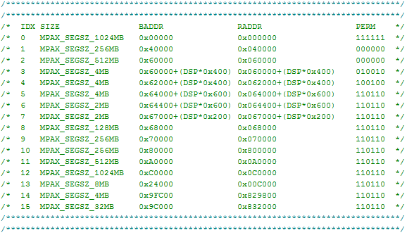

Im working on TCI6638K2K(4ARM+8DSP) Custom Design Board. On my project, all DSP core's exception module is used. I assign adress ranges on DDR3B for all DSP(0x60000000-to-0x80000000). I want to protect these regions to allow every DSP can Read/Write for only own assigned address range. I changed XMC Registers for protection.
Here is the DDR3B mapping(DSP:0-7);
Here is the DSP1 XMC registers;
Here is the DSP2 XMC registers;
for DSP1, Idx=6 says that, ADDR=0x62400000 mapping to ADDR=0x062400000 and permissions are Readable&Writeable&NotExecutite for next 4MB(Reference Section 7.2.1: sprugw0c.pdf). But DSP1 cannot read&write for this region, exception occured(XMPFAR=0x649A45E0, XMPFSR=0x00000110).
Region 0x64000000-to-0x67000000 is divided 8 part for each DSP has own 6MB. Using MPAX IDX 5&6 for this region(4MB + 2MB).

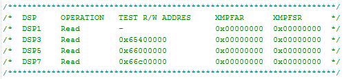

I checked permission of regions for all assigned regions. DSP0,2,4,6 can read/write their own regions and cant read/write another assigned region. But DSP1,3,5,7 failed to read/write their own regions. Last time, i tried adresses below and exception occured, but XMPFAR is zero. What does it mean if XMPFAR&XMPFSR is zero?
Is it something wrong with options?
Thank you,
Srt

    Protection problem is because of alignment. I was trying to protect 4MB region which starts not-4MB-align address. Here is;
    Other problem is waiting. When exception occured, XMPFAR&XMPFSR is zero, What does it mean? How can i find access denied adresses?
    Srt
  • Srt I will try and work with you
    You are right when you say that the logical and physical address in the MPAX registers must be aligned to the segment size. This will explain the differences between even cores and odd cores.
    My question - do you still have a problem and if so, can you describe the problem?
    When you describe MPAX registers please tell me explicitly what is the register number, base address logical, base address physical, size and permission.
