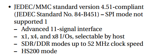

Pin a note AM437x the boot of the mmc .
reference:《AM437x ARM®Cortex™-A9 ProcessorsTechnical Reference Manual》
