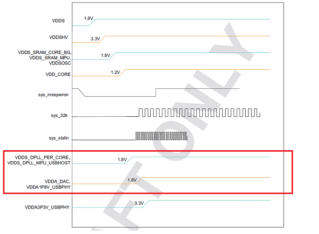

There is a confusion with AM3505 Power-up sequencing from the datasheet and reference documents.
As per the latest datasheet, the VDDS_DPLL_xx and VDDA1P8V_USBPHY could be ramped up at the same time.
But as per the power reference design and the wiki Design In Guide,
it is mentioned that VDDA1P8V_USBPHY should be ramped after VDDS_DPLL_xx.
http://www.ti.com/analog/docs/refdesignovw.tsp?familyId=64&contentType=2&genContentId=68614
http://processors.wiki.ti.com/index.php/AM35x_with_TPS65023:_Design_In_Guide#1.8V_Operation_Sequence
Could you please let us know which one is correct,
can we assume the latest datasheet is the proper one and it is ok to ramp-up simultaneous
and can we use the same 1.8V power source for both VDDS_DPLL_xx and VDDA1P8V_USBPHY?

    Please check this document: www.ti.com/.../slva411.pdf It also shows the two 1.8V supplies in question sequenced in different steps, yet there is no delay requirement for them. You can safely follow the datasheet requirements.
    About the VDDS_DPLL_MPU_USBHOST and VDDS_DPLL_PER_CORE question, there are 35mVpp ripple requirements for these supplies, that's why it's recommended that they are tied to a separate voltage source.

  • You must ensure the ripple voltage requirements are met if you do this.

  • No, there are no specific requirements. As a safeguard it would be good to keep voltage difference between 3.3V and 1.8V rails <2V to prevent overstressing the device.
