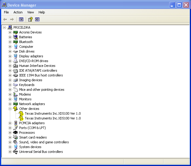

    Could you post a screen shot of what the XDS100 USB devices show up as in your Device Manager?
    Mark
  • I have been scouring both of those pages and I have not seen anything similar.
  • Something went wrong with the driver installation.  The XDS100 emulator should be listed under the Universal Serial Bus controllers as:
         TI XDS100 Channel A
         TI XDS100 Channel B
    When you said you pointed at the Spectrum Digital folder, did you point to the folder with the .inf file in it or the top level Spectrum Digital folder on the CD?  You need to point to the .inf file appropriate for your CPU.  If you didn't point to the .inf folder, then I suggest uninstalling the 2 drivers above with the yellow question marks and trying again.  There appears to be some issue with your USB driver install that I have not seen before.

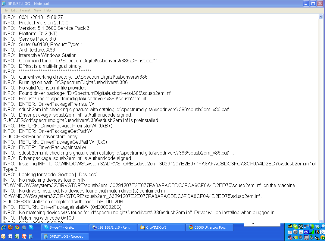

    I did point to the proper directory (SpectrumDigital\usbdrivers\i386) on the CD. It comes back with a Cannot Install.
    I appreciate the help and I realize this has not happened before. I have also tried to run the DPInst.exe. It finishes with a success, but no drivers installed.

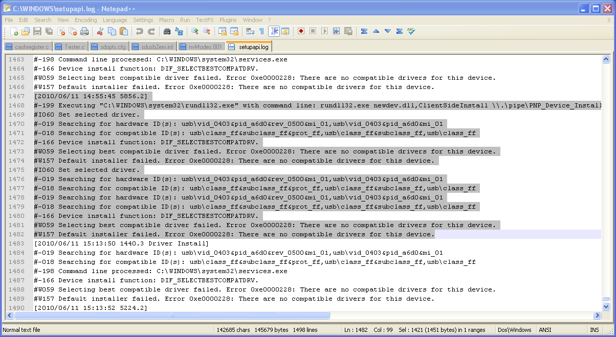

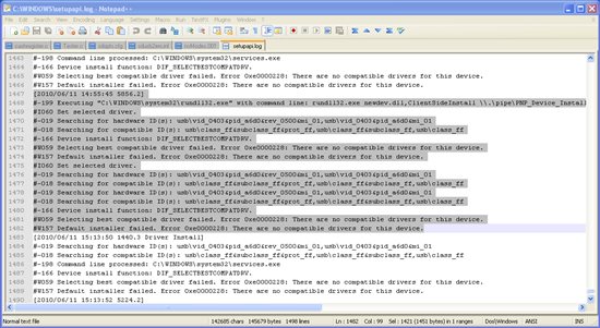

    Here are the log files. I do appreciate any help.

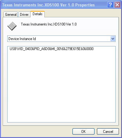

  • Can you check the UID/PID? http://processors.wiki.ti.com/index.php/XDS100#Q:_How_can_I_check_if_the_VID.2FPID_for_the_EEPROM_are_programmed_correctly.3F
    Also, in another message, can you confirm that it worked on a windows XP, sp2 machine, but not on this windows xp sp3 machine? (Assuming same  CCS installed, same HW, etc.).
  • Have not tried on an SP2 machine.
  • Ok, it looks like the eeprom is programmed correctly. We have not seen that before. I will move this post to the CCS forum where other experts can comment.

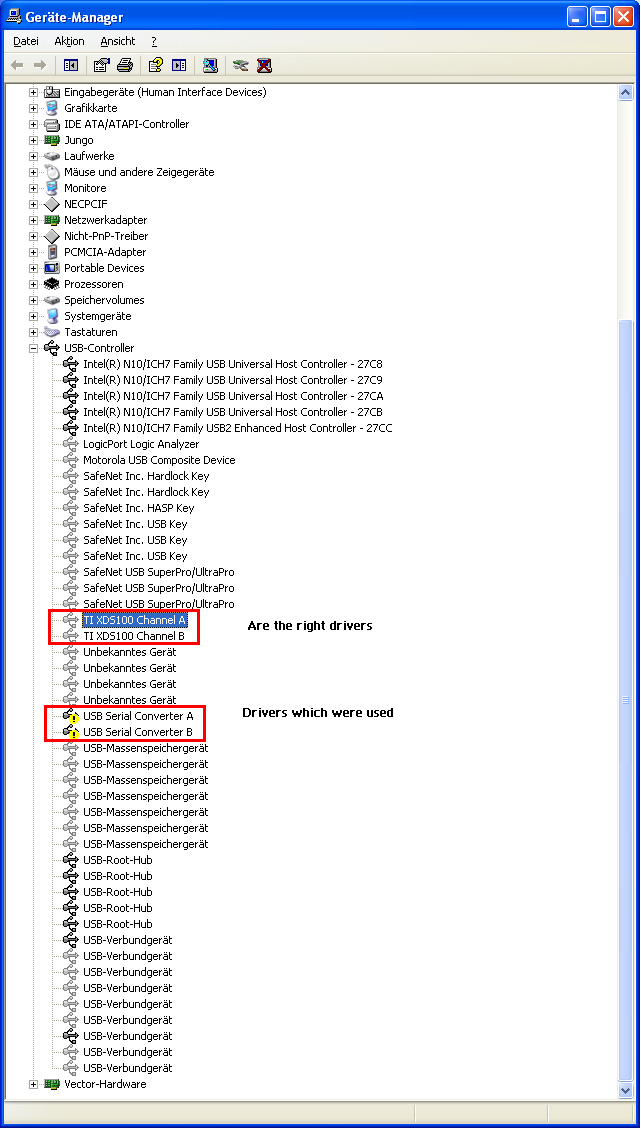

    I have a very similar problem:
    My PC (Windows XP SP3) doesn't detect my stick correctly although the right driver is installed
    (The exclamation point appears because I haven't rebooted the PC after anew try detecting the stick right)
    The right driver have these values: VID=0404, PID=a6d0
    The false one have: VID=0403, PID=6010
    I've already tried to uninstall over the device manager the false one (the registry entries were also deleted) and plugged in the stick, but the false one was installed again
    How can I delete the false one completely and force the PC to take the right one?
    I'm appreciate for any help
    Lena
    BTW: I've also started a thread: http://e2e.ti.com/support/microcontrollers/hercules/f/312/t/223915.aspx

  • No, unfortunately not everything.
    To get the right driver, I reprogrammed the device with MProg (the programm read sth. with BeagleBone, after the programming it was sth. with TI). Then the PC took the right driver.
    But I had problems flashing the device in CCS and nowFlash and I don't know, why it works now. I tried to change the device configuration in ccs, that didn't help. Then I resetted the changes and it worked, although I had the configuration already before.
    So I'm confused, but it works and I hope this error doesn't appear again.
