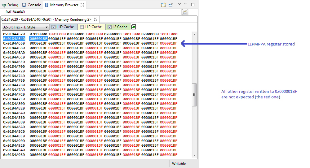

I'm currently developing an application on the TMS320C6678 using ASM and CCS6.1.1 and I have a question about MPU registers of L1P, L1D or L2 memory.
I want to give different levels of  access for those memory so I use the MPPA registers dedicated to each memory to give supervisor/user rights. (Cf "C66xx CorePac User Guide").
All the register are written normally but when I store value in MPPA registers for the two last pages (L1PMPPA30 and L1PMPPA31 for the L1P memory), there is many other registers written at the same time.
I would like to know if this is a normal behavior or if it is caused by a issue in my code?

    1. Have you tried writing those registers from CCS memory window? Is it affecting other registers?
    2. Is it affecting the expected output of your program?

    I tried to write those register from the CCS memory Windows and it gave me the same result, every other register are written with it.
    I don't know if it is affecting the output of the program yet. But as it is a critical application I don't want to have unwanted behavior later.

    I may be wrong here, but I am not sure that 6678 uses all 32 MPPA registers. Let's see what happens when you try to manipulate register 15 and register 16 (starting from 0) and compare it to the behavior of register 30 and 31.
    In general, when you change one register and some other register is changed it points out for some link between the two registers.
    Get back to me with the results of your experiments (change MPPA 15 and 16)
