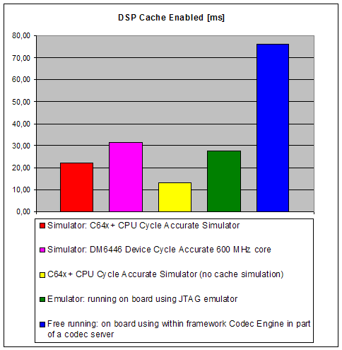

I have an own developed XDAIS compliant IUNIVERSAL algorithm (MYALG) running on DM6446 SoC's DSP.
I would need real time processing.
Reaching that, I need run MYALG process less than 30 ms.
Processing time (algorithm's performance) calculation is performed by TSCL (there is no overrun, and I don't need to use TSCH).
TSC is the DSP's own timer, so it seems to good timer for measure execution cycles.
In addition, processing time is measured by MYALG itself, inside of its function ALG_process(), so it is measured only the DSP running time.
After some digging (due to some performance issues), I found some strange processing times.
Simulator timing, JTAG emulator timing and the real time running (in a DVSDK environment) are quite different.
I would understand the Simulator and others differences due to the quality of the simulation accuracy (although, I tried to set the best simulator's parameters).
But, I don't understand the JTAG emulator and real time running differences.
Processing times are 2-3 times slower in real time environment than using a JTAG emulator.
Once again: this processing times measured only DSP running in function ALG_process() !
So, I need some optimization work, but I don't know where would I start it.
I would appreciate if anybody would explain the reason of this performance decreasing.
Should I make some configuration steps, or would I need to accept this performance ratios?
Peter

The measured benchmarks are:
A.1./ When DSP cache is disabled:
92.67 ms ( 55,043,713 sysclk) - Simulator: C64x+ CPU Cycle Accurate Simulator
316.60 ms (188,061,064 sysclk) - Emulator: running on board using JTAG emulator
A.2./ When DSP cache is enabled (L1P=32K, L1D=32K, L2=64K):
22.07 ms ( 13,109,186 sysclk) - Simulator: C64x+ CPU Cycle Accurate Simulator
31.70 ms ( 18,829,160 sysclk) - Simulator: DM6446 Device Cycle Accurate (600 MHz core)
27.46 ms ( 16,310,579 sysclk) - Emulator: running on board using JTAG emulator
A.3./ Simulator without cache simulation:
13.07 ms ( 7,765,643 sysclk) - C64x+ CPU Cycle Accurate Simulator (no cache simulation)
B.1./ When DSP cache is disabled:
575.10 ms (341,609,968 sysclk) - Free running: on board using within framework (Codec Engine, in part of a codec server)
B.2./ When DSP cache is enabled (L1P=32K, L1D=16K, L2=64K):
75.97 ms ( 45,124,660 sysclk) - Free running: on board using within framework (Codec Engine, in part of a codec server)
