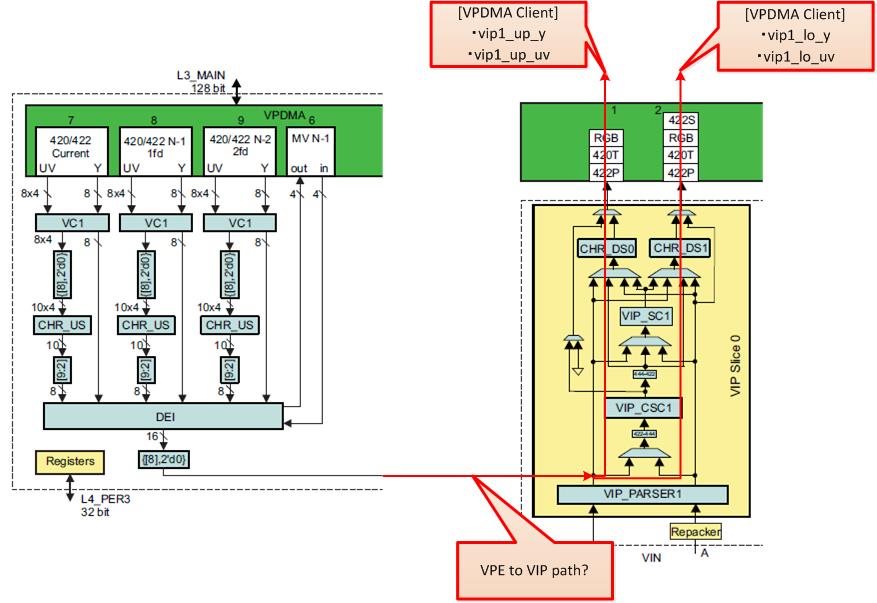

Please let me two questions about VPE.
1. VPE can be output from 2 client?
VPE is supporting video output by the next VPDMA client.
    AM572x TRM
      Chapter 10. Video Processing Engine
        Table 10-17. VPDMA Client Buffering and Functionality
        - vip1_lo_y
        - vip1_lo_uv
However, the figure has been entered in the VIP from VPE.
    AM572x TRM
Can VPE output video from the next VIP1's VPDMA client?
    AM572x TRM
      Chapter 9. Video Input Port
        Table 9-32. VPDMA Client Buffering and Functionality
        - vip1_lo_y
        - vip1_lo_uv
2. VIP source point
The output of the VPE is connected to the part of the VIP?

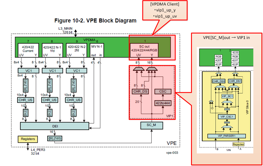

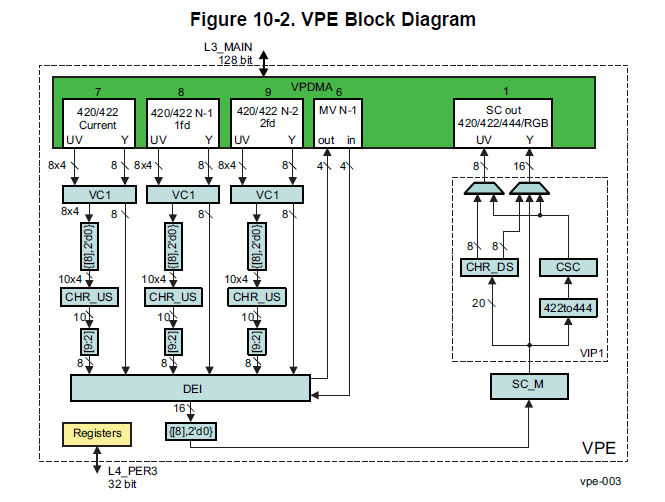

  • Hi Yordan,
    Thank you very much for your very valuable information.
    I read AM5728 Technical Reference Manual (Rev.F), and I thought VPE shared a hardware resource of VIP1.
    1. An output side VPDMA client of VPE is same as VIP1 output side VPDMA client.
          - vip1_up_y
          - vip1_up_uv
    2. It's connected to VIP1 from SC_M of VPE.
      Figure 10-2. VPE Block Diagram
    Isn't VPE sharing a hardware resource of VIP1?
    Thanks and Best Regards,
    Ryuta
  • Hi Ryuta,
    No, what you point in the figure is NOT a shared hardware resource.
    The common thing is that BOTH VPE & VIP use VPDMA.
    For VIP the path is: Camera sensor -> VIP -> VPDMA
    For VPE the path is: VPDMA -> VPE -> VPDMA
    Best Regars,
    Yordan
