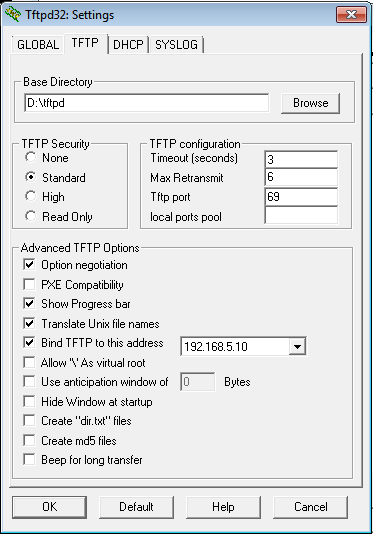

4. tftpd utility settings are followed as per the wiki page example.

  • 1. Please ensure that the TFTP & DHCP configuration are correct and make sure that the eth_data.bin is available under TFTP path and the same path has been configured in the utility.

    3. PC address is set as 192.168.5.10
