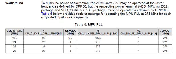

We have a custom board based on AM3351 and it is a battery operated. What is the minimal operating frequency is possible on the AM3351. The current processor-sdk-02.00.02.11 supports the minimal frequency of 300MHz. Is there any changes to the current sdk possible that would reduce the frequency further.
