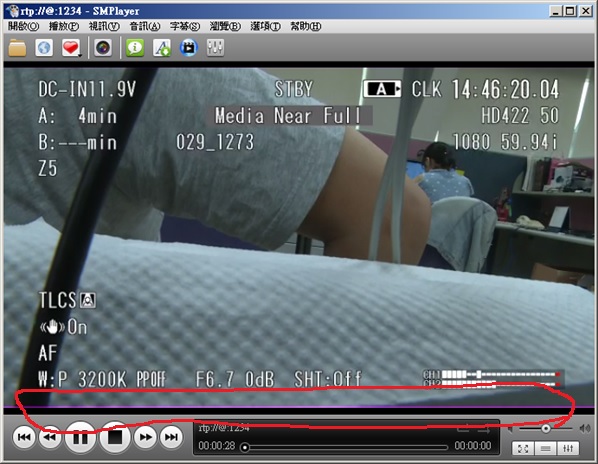

Dear Experts,
We have problem on DM8148 video encode.
Signal path:
Camcorder SDI -> Platform (DM8148) -> MP4 or Streaming.
Platform input is 1920x1080 59.94i SDI signal.
If we set output size to 640x368 progressive,
picture of VLC player or SMPlayer has purple line on lower side.
Plz check below figure.
If we set output size to 640x360, it has no problem.
But our customer request us to provide 640x368 size output.

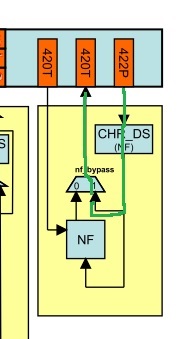

Is there any limitation on SCLR or encoder to cause this situation?
Can we resolve it or it is limitation?
