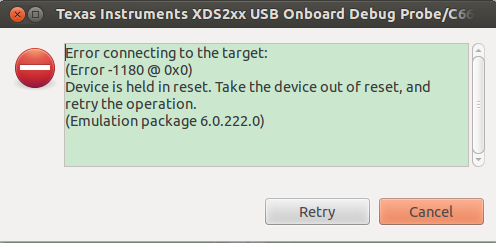

  • Hi Xiaop,
    The error appears to me that the C66x is not taken out from reset.
    Follow this wiki to do that and revert to us.

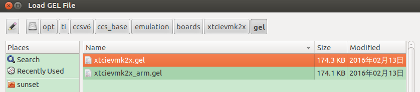

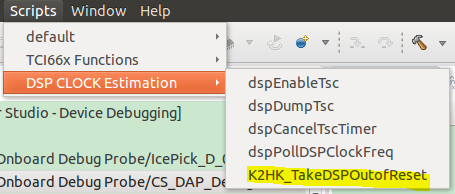

  • Hi, Shankari

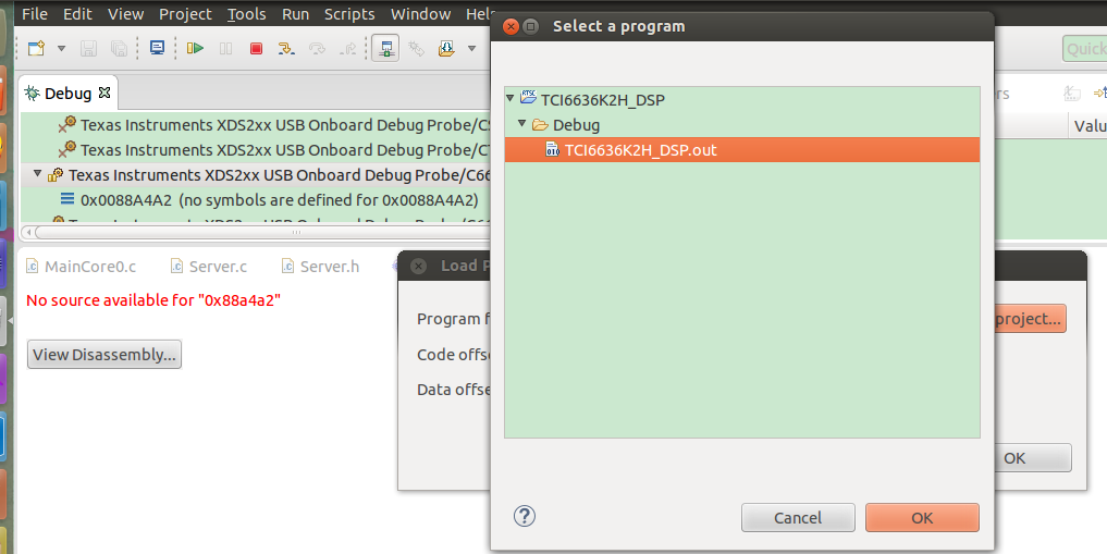

    First of all, I want to answer the question about GEL file for EVMK2H. I have find a GEL file in the CCS6 dir named  xtcievmk2x.gel, and
    took  all the dsp cores out of reset sucessfully. Debuging the IPC example in DSP part is the next thing I have done, however, I find there is
    another thing confused me. I can compile the core0 program sucessfully, but it of no use to run. I will explain that in detail:

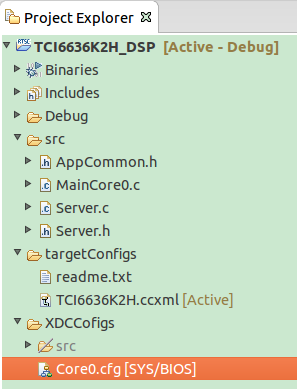

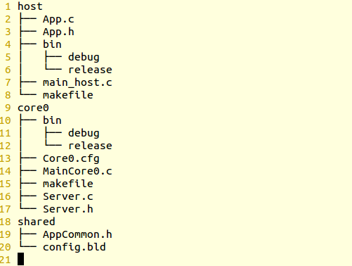

    1.the tree of /opt/ti/ipc_3_42XX/examples/TCI6636_linux_elf/ex02_messageq list below:

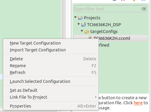

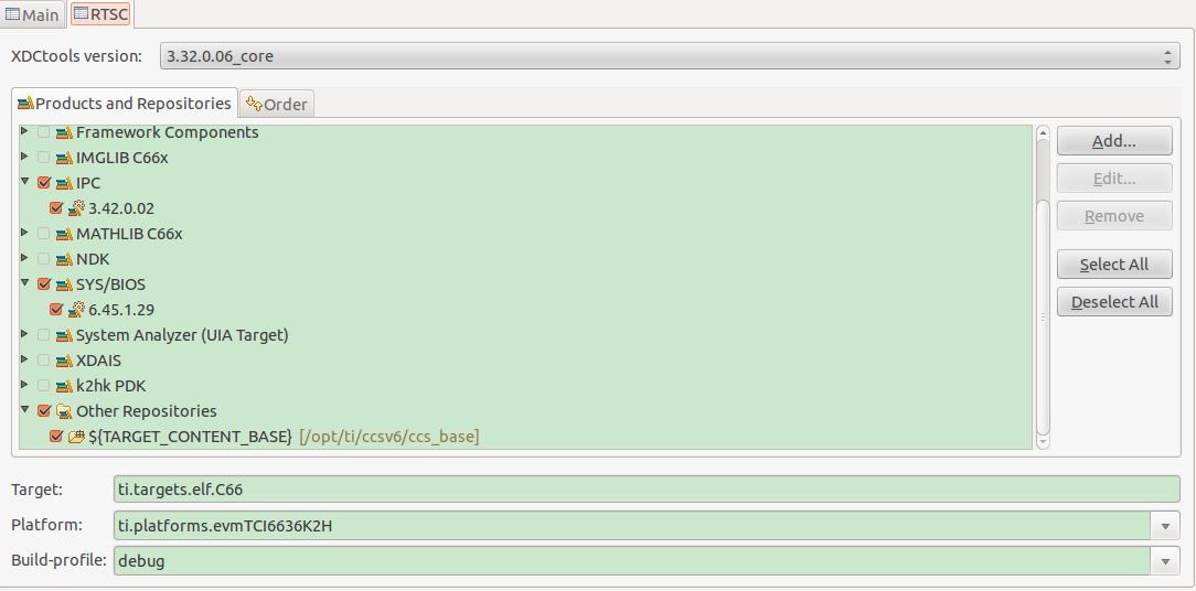

    2.Because of I only use the source file of core0 and host, so I just list the structure about my problem. Then I use the sourcre file of core0 and shared
    to construct a CCS project named TCI6636K2H_DSP, configurations list below:

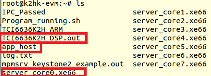

    3.there is point I want to mentioned, I build the project just according to the makefile in the source file in IPC examples. And compile it sucessfully. And
    post the binary file TCI66K2H_DSP.out to root dir. The binary file for test list below

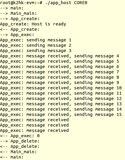

    4. the program running succesfully when I use the server_core0.xe66, which compile without CCS and results list below
    5. when I use the binary from CCS compiled, the results is kind of different, and I can't figure it out. Here I know there is no information like
    "creating channel rpmsg-proto addr: 0x3d", whose results list here:
    6.this is the problem I am confused here.
  • Then I do as you mentioned above in the wiki. I do as follow to make DSP cores out of reset. And it really work well.
    8.The discript works well. Then I loaded my program I build before. And debug it wihout breakpoints.
    9. The same wrong results as post above. And I don't how to solve it.
    Finally, I have tested the method you mentioned by using loading mpm example, and have the same results.
    I know how to debug my program through CCS when botting from SPI boot mode. However, there is another problem
    I am facing with I don't know why I can't run the program sucessfully. And the problem is refeered to the configuration in
    the CCS project. And I am trying to figure it out.
    xiaop

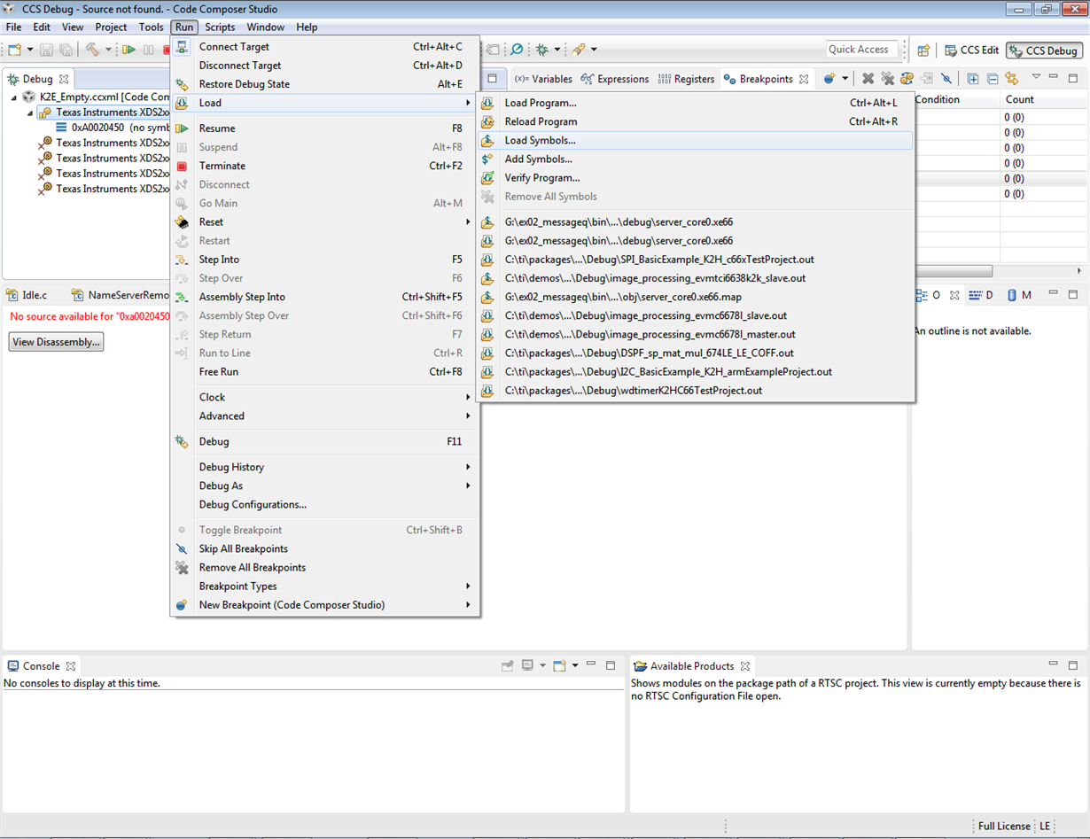

  • Xiaop,
    This is the step by step procedure for debugging ex02_MessageQ example on K2E board
    Debugging steps:
    mpmcl load dsp0 server_core0.xe66
    mpmcl run dsp0
    Do not make any changes in the BOOT switch settings of the EVM
    In CCS, Launch the empty K2E cxml file without any Gel file
    connect target
    Load --> load symbols --> select server*.xe66 Put more Hardware breakpoints after browsing the map file. run
    In the console of ( Linux machine ) launch the app_host ./app_host CORE0
