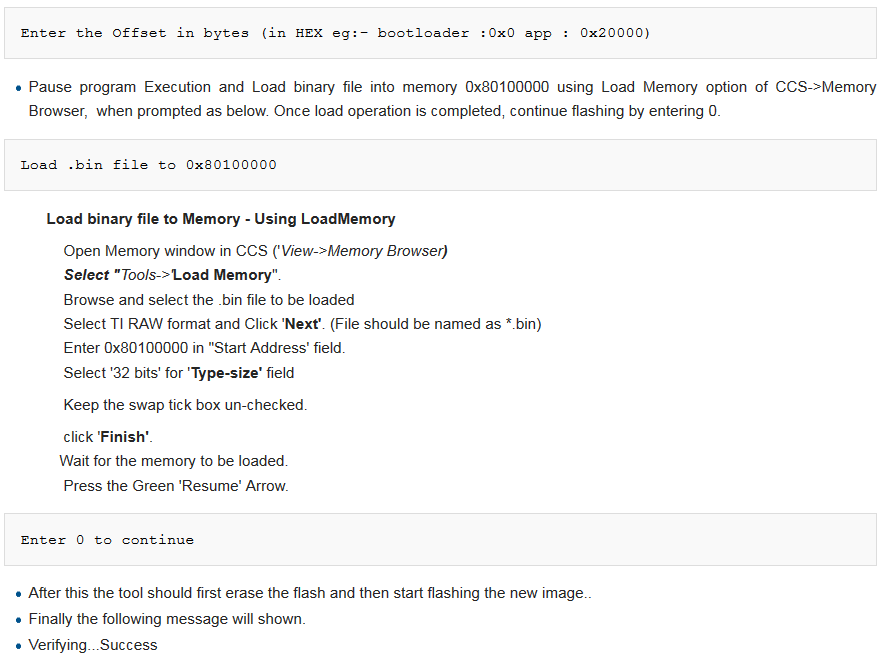

    1) I have done the gel loading but I am not sure how to "Load pre-built isdk_spi_flasher.out to ICE" in order to get the following prompts :

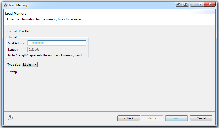

    2) What I could do is this "Load binary file using LoadMem". Is it the same as the above?
    which looks like this :
    3) Which leads to follow-up question : is this Loading permanent? I haven't clicked "finish" yet.

    for Q1, please follow processors.wiki.ti.com/.../SYSBIOS_Industrial_SDK_Getting_Started_Guide Here in step 7, please browse to C:\TI\sysbios_ind_sdk_2.1.1.2\sdk\tools\isdk_image
    Q2: For this procedure you are loading/running first the "flasher" .out in CCS, and then using LoadMemory you are loading in DDR the application binary that you want to flash in NOR memory
    Q3: No the load is not permanent, here, as explained above, you are loading your binary in DDR, then the flasher will copy what you loaded onto non-Volatile memory (NOR memory)

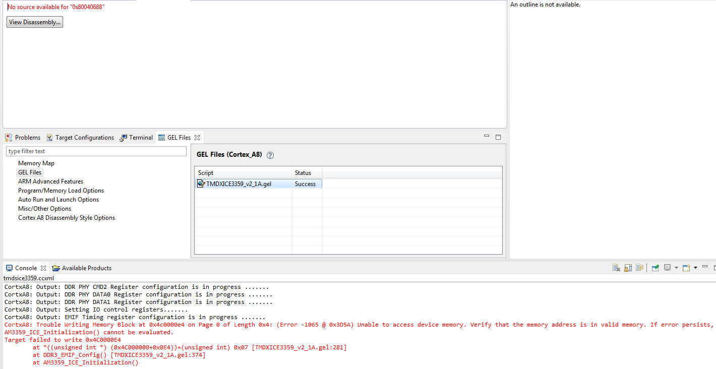

    I went through step by step with the link you provided and came up with a couple of errors, and a question.

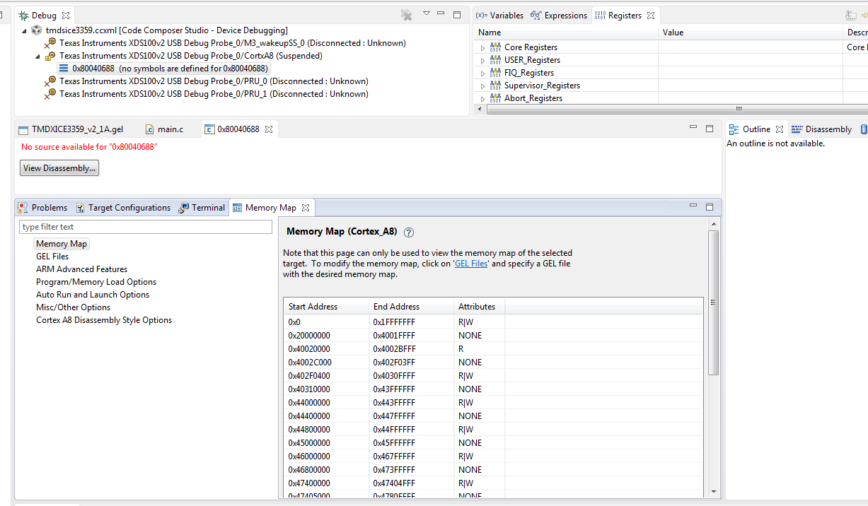

    1) I connected the ICEv2, launched Target Config ( Which I have set before with the Gel 'TMDXICE3359_v2_1A.gel'). Upon connecting the CortexA8, I had this 'No source available' issue. Can this be ignored for now?
    2) Assuming yes, I went on and resetted system, nothing loaded ( which meant there was no valid application in the SPI/NOR flash), selected Suspend.

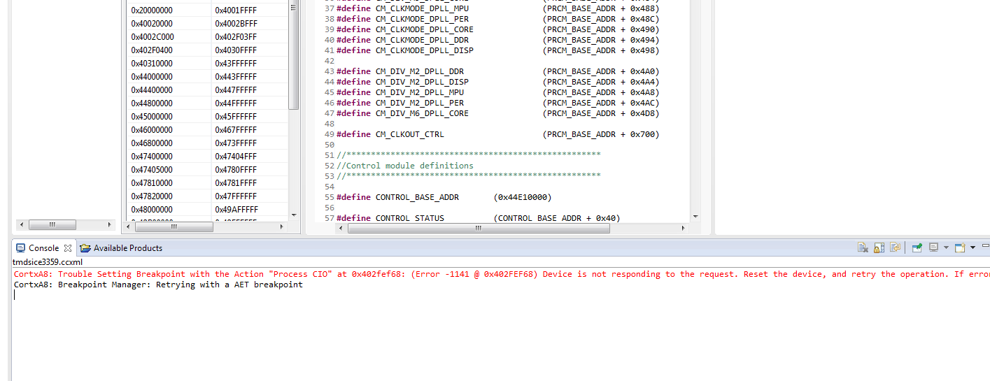

    3) I then proceeded to execute initialization script - which led me to this error. How should I circumvent this?
    Please provide assistance.

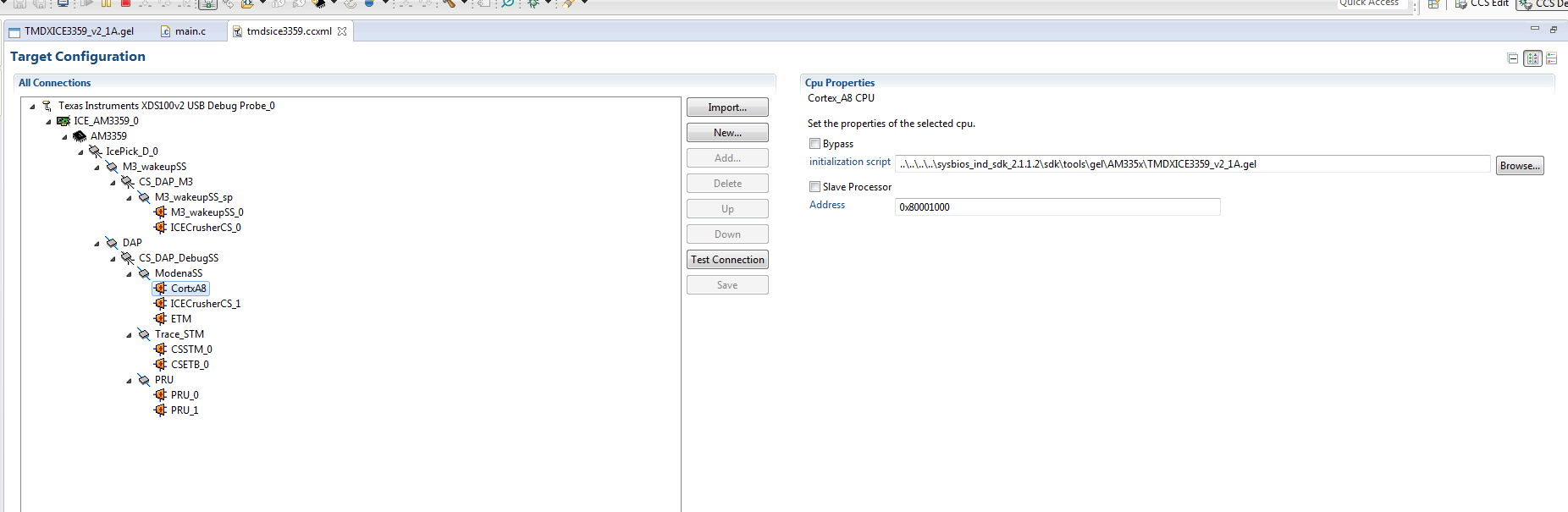

    here is the 2nd part. With the 1st part above, I assumed that since i already completed the settings for the TargetConfig earlier, I didn't have to 'reinitialize' via Scripts>AM335x>System initialization. Here is my TargetConfig that I did much earlier :
    I loaded the isdk_spi_flasher.out and got this error. I read that I have to put a hardware break somewhere. How do I do that exactly ( specifically for the SPI )?

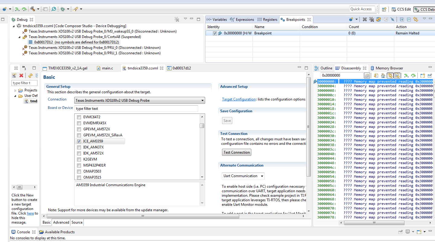

    I tinkered around a little more and found where I could potentially put the HW breakpoint. Is this right?

  • Hello Paula,
    no more issues regarding that. I just followed the guide you provided very carefully and erased the SPI flash.
