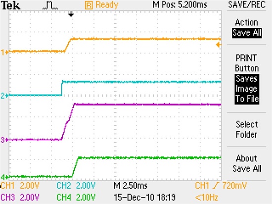

  • I had the same question than Mariana so I've been worked on my EVMOMAPL137 to test the power sequence at power-up. Well, I'd like to post the result that shows 1.2V -> 3.3V -> 1.8V sequence as well.
    ch1: 1.2V
    ch2: Alternate 1.2V
    ch3: 3.3V
    ch4: 1.8V
    Board: EVMOMAPL137 Rev.F
    Regarding to the power-off sequence. what could happen if I power off the 1.2 and 1.8V while I keep the 3.3V active?
    If you power on the 3.3V while the other rails are unpowered, I believe it will stress the transistors inside the device.
    How long are you planning to leave the 3.3V active with everything else unpowered?  If it's a very short time (e.g., milliseconds or less), then it would probably not stress the transistors too much.  However, I would not recommend leaving it on for too long.
    Is there a reason why you would like to leave the 3.3V active?
    --Christina
    Oh no, I wouldn't like to do it. Especially, taking into account your suggestion :)
    Actually I've got some C6747 custom boards that definitely do not work. Simply, devices are not able to connect to the emulator through JTAG interface. This could be an assembly issue (Maybe a X-ray inspection could get me out of doubts) but I wonder If I was wrong when I powered the device with only 3.3V. Since in our power supply design there were also some bugs.
