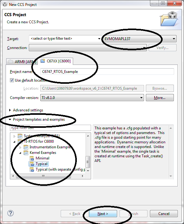

    No I am not able to create the example based on RTOS on ccs v6. When I go to File, New CCS Project I cannot find EVMOMAPL137 in the target list. Could you help me with that first? is it to do with XDCtools versions? thanks.
    Mitesh

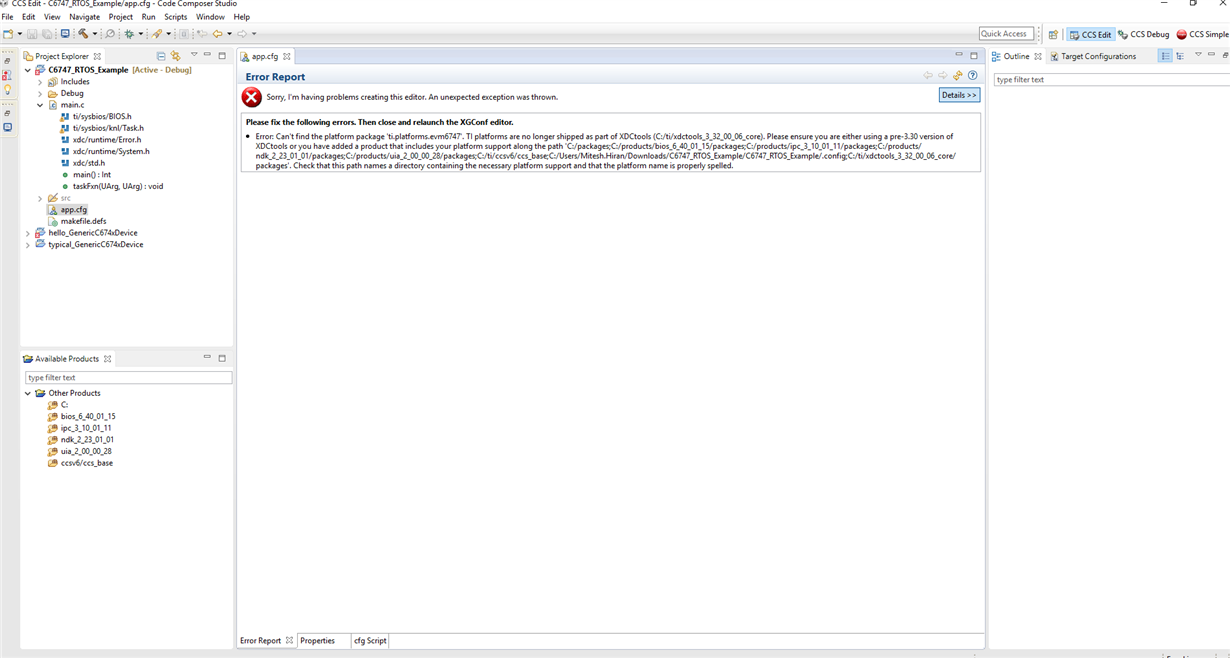

  • This is what error message I got, when I tried to import your attached project and tried to open app.cfg file.
    Thanks.
    Mitesh

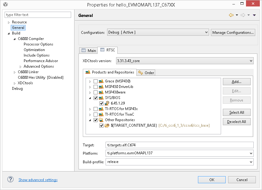

  • Can you tell me what version of the SYS/BIOS should I install in order to get targets files for OMAP-L137 / TMS320C6747 ? thanks.
  • Mitesh Hiran said:
    Can you tell me what version of the SYS/BIOS should I install in order to get targets files for OMAP-L137 / TMS320C6747? thanks.
    SYS/BIOS 6_45_01_29 supports the OMAP-L137:
