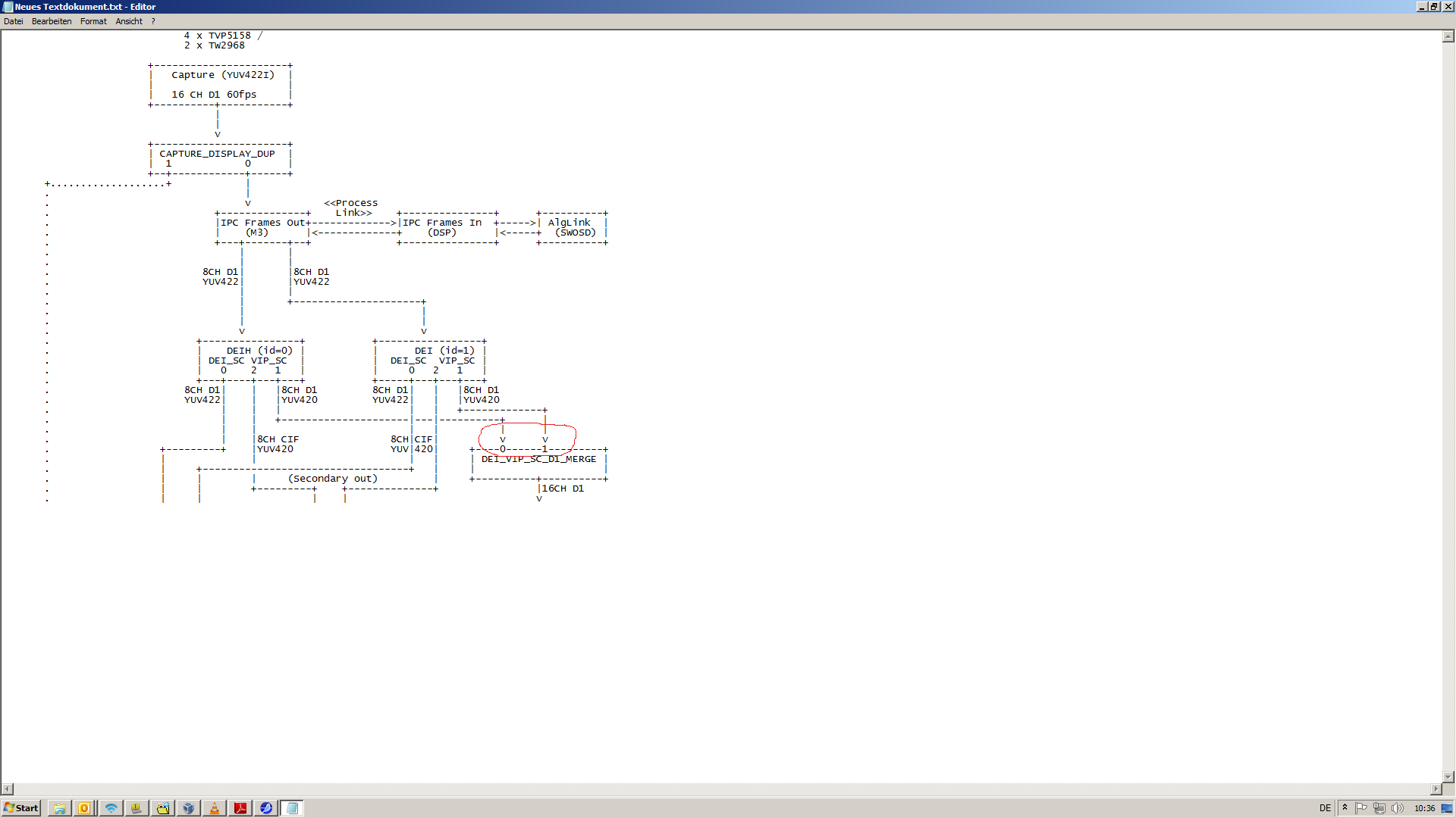

    We use multichannel_progressive_vcap_venc_vdec_vdis usecase from DVRRDK MCFW.
    The captured 16 channels are split into 2 parts of 8 channels.
    The second 8 Encoder channels get get the corruption.
    BR Holger
    If I change the order of the input of DEI_VIP_SC_D1_MERGE I can move the corruption from channel 9...16 to channel 1...8.
    So it seems that the problem occurs in the De-interlacer before.
  • Ok, the corruption disappears after disabling tiler for deinterlacer:
      deiPrm[i].tilerEnable[DEI_LINK_OUT_QUE_VIP_SC] = FALSE;
    Does anybody have similar problem ?
    BR Holger
