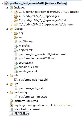

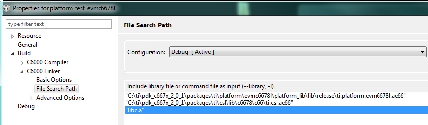

Here is a screen shot of the linker includes:
Here is a view of my project:
If there is any other screen views that I could upload that would help find the problem please let me know. I'm getting closer but still need help.
Joe
  • Can you please attach your project ?
    Also attach the log when you do "Rebuild Project".
  • Hello, here is the project and the latest Compilation errors. I don't know where to find the log you are requesting after I do "Rebuild Project".
    platform_test_evmc6678l.zip

  • I have modified the Linker settings and able to build without any problem.
    Please try this and let me know.

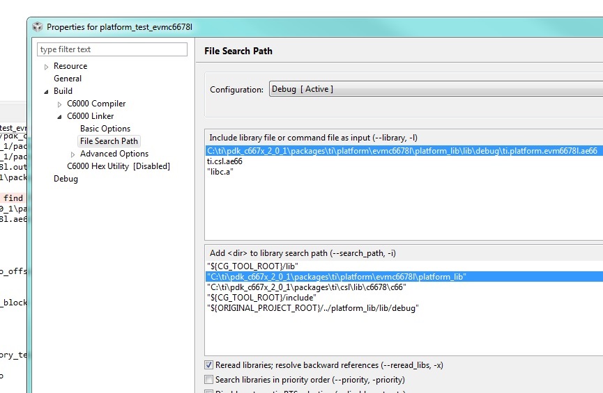

  • Hello, thank you very much for helping me with this PlatformTest. I downloaded the zip file and compiled the project.
    Here are my errors:

    Any ideas? I didn't modify anything in the project.
    Thanks again for sticking with me to solve this problem. Joe

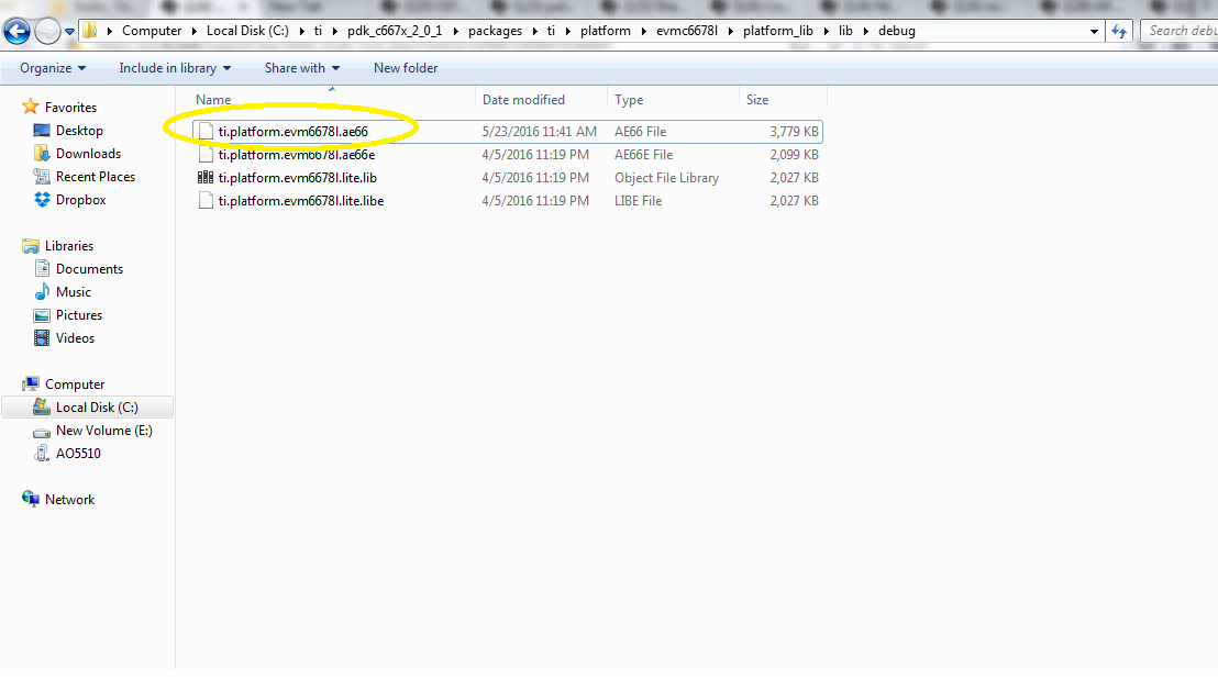

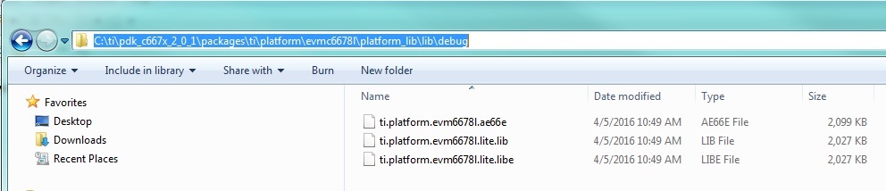

  • I think, you don't have libraries in below location.
    C:\ti\pdk_c667x_2_0_1\packages\ti\platform\evmc6678l\platform_lib\lib\debug\ti.platform.evm6678l.ae66
    If yes, can you please rebuild the platform library in debug mode and rebuild this platform test code again.
    Import this CCS project in CCS and rebuild it.
  • Titus,
    Hi, do have those libraries and did rebuild the project. Here are my compilation errors:

    Here is a screen shot of the C:\ti\pdk_c667x_2_0_1\packages\ti\platform\evmc6678l\platform_lib\lib\debug directory:
    Here is a screen shot of my Linker Properties:
    Hope this helps us find the problem. Should I de-install the PDK and then install it again?  Joe
  • Dear Joe,
    No, you don't have it.
    The file name is "ti.platform.evm6678l.ae66" not "ti.platform.evm6678l.ae66e"
    ti.platform.evm6678l.ae66  -> Little endian
    ti.platform.evm6678l.ae66e -> Big endian
  • Titus,
    Hi, you are correct. That library was missing so I copied the one from the Release directory and was able to compile the code and run the example. Will this library be okay from the Release directory? Thanks
  • Yes, its okay, its the same but it doesn't have debug information which is not required for library.
    If you wish, you can also import the platform library and build it with Debug mode.
  • How do I import a platform library?
  • Import the following project which is platform library.
  • Titus,
    Hi, thank you very much for helping me get this going and finding my errors. I did try to compile the platform library but got 52 errors. I'll work on it a little more and if I can't get it going I will do a post to the forum.
    Thanks again!
