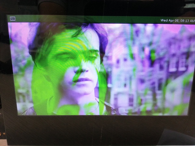

hi.
I was converted to interlaced from TearOfSteel-AV-Short-720x420.mp4 video provided by the sdk.
I am not sure of the option gst program are wrong.
sdk version : 2.00.02.11
kernel : 4.1.18
gst : 1.2.3
command : gst-launch-1.0 -v filesrc location=/TearOfSteel-AV-Short-720x420.mp4 ! qtdemux ! h264parse ! ducatih264dec ! vpe ! waylandsink
    I will forward this to the software team.

  • Hi HYEON SEOK LEE,
    I think your problem is in the gstreamer pipeline you are using. If you had and interlaced video, you do not need to use the vpe element.
    This is the pipeline I used to display an interlaced video:
    gst-launch-1.0 filesrc location= mm6-30-16FINAL.mp4 ! qtdemux ! queue ! h264parse ! ducatih264dec ! kmssink scale=false connector=30
