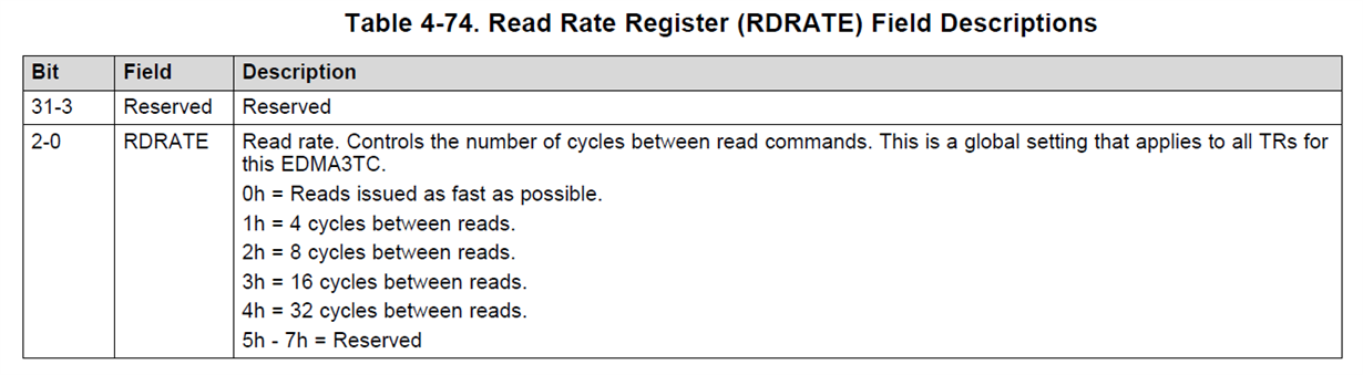

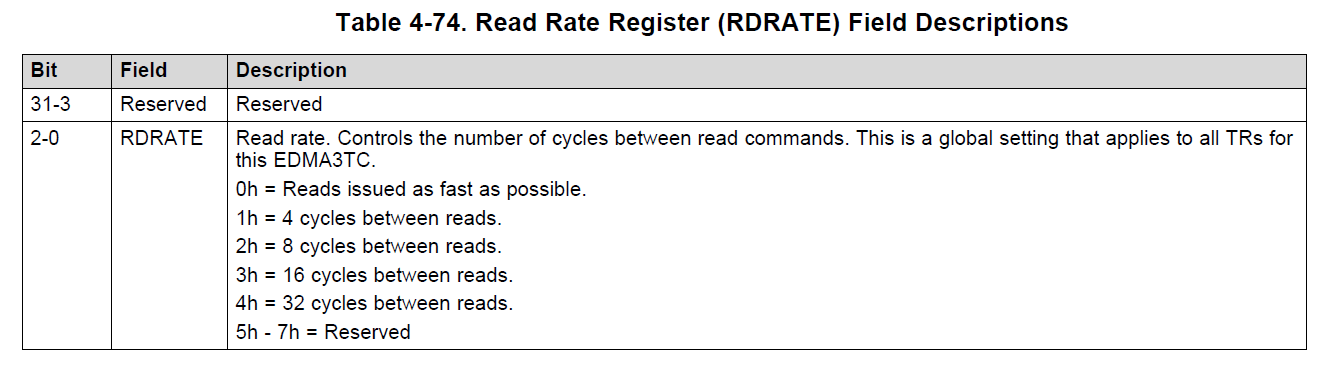

I'm considering to inhibit a throughput between EDMA and PCIESS. I send data to the outbound buffer of PCIESS by TC0 and TC1. I want to control a detailed management of EDMA transfer from IRAM to PCIESS. Please give me some advice.
1) Can I set RDRATE register of EDMA greater than 4h? I want the read rate to control more slowly.
2) Can I control TeraNet to slow EDMA transfer?
3) How many bytes does the outbound buffer of PCIESS have? Can I adjust the size of it?
