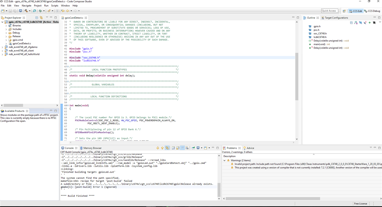

  • Hi Titus,
    Thanks, Yes I will trty to load GPIO example design. I have imported the example buyild project and when I try to build ccs errors out stating :
    The system cannot find the path specified.
    makefile:154: recipe for target 'post-build' failed
    A subdirectory or file ..\..\..\..\..\..\..\binary\c674x\cgt_ccs\c6748\lcdkC6748\gpio\Release already exists.
    gmake[1]: [post-build] Error 1 (ignored)
    Any idea how to give CCS write access?
    Mitesh
  • Import the following project and rebuild on CCS.
    C:\ti\C6748_StarterWare_1_20_04_01\build\c674x\cgt_ccs\c6748\lcdkC6748\gpio
    Can you please attach your screen shot of your problem?
  • You can ignore this error, its created a .out.
    Now ,you can connect target and load the code.
  • No, Titus, I have checked the time stamp on the *.out file is still 2012! It didn't build the out file..
  • I hope its building fine.
    You can also delete the debug and release folder of that project on CCS IDE and do rebuild the project.
  • I did delete the Release folder and when I asked to rebuild it just recreated the Release folder! no out file.
  • Have you modified the project settings or properties ?
    I just import it and able to build with out any problem.
    By default, its configured to "Debug" setting not "Release" that's why I suspect, you may have modified the project.
  • Hi Titus, Just switched the Build Configuration to Release to see if it makes any difference to the error. I have switched it back to Debug but it still complains post-build failed.

  • This error can be ignored, now you can see updated .out file in debug folder.
  • I made some changes to the write access to my user account and it seems to work now. Thanks for your support and yeah EMAC client example seems to load properly from flash.
