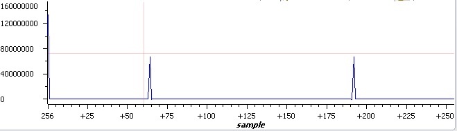

 I compiled and run example provided in  'C:\ti\dsplib_c66x_3_4_0_0\examples\fft_ex\fft_example.c'

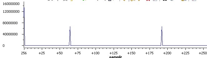

The output is ok for  DSP_fft16x32 and DSP_fft32x32,  that is,  the output is the same as  C:\ti\dsplib_c66x_3_4_0_0\examples\fft_ex\refOutput.jpg

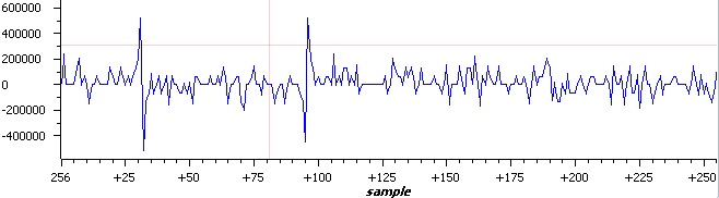

the output from DSP_fft16x16 function is not ok , i.e, the plotted graph is different  from reference output

    I did the following.
    1) Copy and paste your code from ''C:\ti\dsplib_c66x_3_4_0_0\examples\fft_ex\' into my prj
    2) change the name of the main function to 'testFFT'
    3) change costant NUM_SIN_WAVES from 4 to 2
    this will generate the input array (costant value + a sin, see function 'generateInput')
    4) call function 'testFFT' (your main)
    Result 32x32 (OK)
    Result 16x32 (OK)
    Result 16x16(?????????)
    Then I changed from 'DSP_fft16x16' to 'DSP_fft16x16_cn' and did the test again, results are the same
    Fabio
  • Fabio, this is very interesting
    At the first glance I thought that this might be truncation errors but then I realized the locations of the peaks and I agree with you, we need to understand what is going on.
    The good news is that since the cn file gives the same results, we can go through the source code of the cn and try to understand what is the problem.
