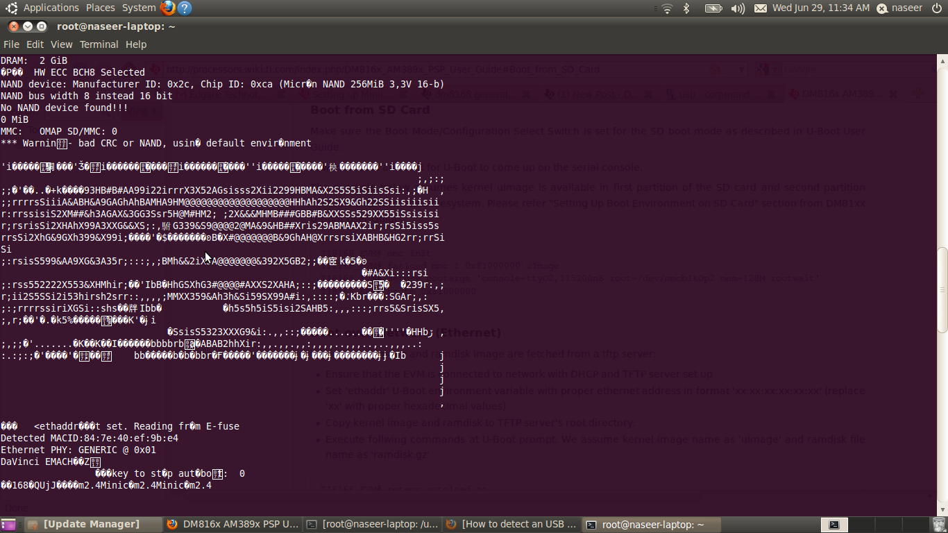

Dear sir,
I have followed the link " then i set hardware flow in minicomstup to NO and software flow also NO.
but i got 2 problems in two sitations,
1)when i connect the board and set the minicom then wen i strart the baord by power up or by restarting the board,i got errors like as shown in attachmnt.it was showing Mac address n ethernet address and stop there only and the images are not and i get different symbols in minicom as shown in attachment.
****but in my TV,I DINT GET main view like settings,2dcamera,3d camera and soon....
why this is happening....?how to solve this...?
2)when i start the board and later on i connect the uart cable then ,it was asking me PASSWORD.
what is the password...?what to do next to that...?
**but in my TV,I got main view like settings,2dcamera,3d camera and soon....

  • HI Pavel,
    I tried with picocom,but result is same...here is the output
    root@naseer-laptop:/# picocom -b 115200 /dev/ttyUSB0
    picocom v1.4
    port is        : /dev/ttyUSB0
    flowcontrol    : none
    baudrate is    : 115200
    parity is      : none
    databits are   : 8
    escape is      : C-a
    noinit is      : no
    noreset is     : no
    nolock is      : no
    send_cmd is    : ascii_xfr -s -v -l10
    receive_cmd is : rz -vv
    Terminal ready
    C�H�� ��t 2010.06 (Apr 29 2012 - 20:35:23)
    DRAM:  2 GiB
    MMC:   OMAP SD/MMC: 0
    Using default envir�nment
    �Z
      ���key to st�.
                    ���bo�t:  0
    ��͕� Signal # 8 caught
    WV�����u-bo�t.bin
    HH�����  �ѕ́read
    �$�х�ѥ���application at 0x80800000 ...
    U-Bo�t 2010.06 (Apr 29 2012 - 20:28:20)
    TI8168-GP rev 2.1
    ARM clk: 987MHz
    DDR clk: 796MHz
    I2C:   ready
    DRAM:  2 GiB
    *9 �  HW ECC BCH8 Selected
    NAND device: Manufacturer ID: 0x2c, Chip ID: 0xca (Micron NAND 256MiB
    3,3V 16-bit)
    NAND bus width 8 instead 16 bit
    No NAND device found!!!
    0 MiB
    MMC:   OMAP SD/MMC: 0
    *** Warning - bad CRC or NAND, using default envir�nment

  • I suspect your cable is damaged. Can you try with another cable between the EVM and laptop?
    The same settings works fine on my side:
    pbotev@mms-0306:~$ picocom -b 115200 /dev/ttyUSB0
    picocom v1.4
    flowcontrol    : none
    parity is      : none
    databits are   : 8
    escape is      : C-a
    noinit is      : no
    noreset is     : no
    nolock is      : no
    Terminal ready
    U-Boot 2010.06 (Aug 11 2015 - 14:32:51)
    TI8168-GP rev 1.1
    ARM clk: 987MHz
    DDR clk: 796MHz
    I2C:   ready
    DRAM:  1 GiB
    DCACHE:  Off
    NAND:  HW ECC BCH8 Selected
    256 MiB
    MMC:   OMAP SD/MMC: 0
    *** Warning - bad CRC or NAND, using default environment
    :,;;:;:;;;;;;;;r;;:,;;:;:;;;;;;;;:,;;:;:;;;;;;;;:,;;:;:;;;;;;;;:;;;;;;;;:,;;:;:
    ;,;:::;;;;r;;;rssiSiS552X5252525259GX2X9hX9X9XX2325S55252i5:,;;:;:;;;;;;;;:,;;:
    ;:;;;;;;;rrssSsS52S22h52299GGAAMHMM#BBH#B#HMM#HMBA&&XX2255S2S5Si:,;;:;:;;;;;;;;
    ;:;;r;;rsrrriiXS5S329&A&MH#BMB#A&9XXA252GXiSXX39AAMMMBB&G22S5i2SSiiiisi:,;;:;:;
    ;;;;;r;rr2iisiih393HB#B#AA99i22irrrX3X52AGsisss2Xii2299HBMA&X2S5S5iSiisSsi:,;;:
    r:r;rrsrsihXSi2&##MHB&Ahh3AGHGA9G9h&#H##@@@##MAMMXXX9SSS29&&HGGX2i5iisiiisisi:,
    ;;rrrrsSiiiA&ABH&A9GAGhAhBAMHA9HM@@@@@@@@@@@@@@@@@@@HHhAh2S2SX9&Gh22SSiisiiisii
    r:rrssisiS2XM##&h3AGAX&3GG3Ssr5H@M#HM2; ;2X&&&MHMB###GBB#B&XXSSs529XX55iSsisisi
    r;rsrisSi2XHAhX99A3XXG&&XS;:,rH#HGhAS   @@@@3rs2XBM@@A552&&AHA2XiisSS252SSsisSs
    r;issi5S22&&3iSSX292&hXsr;;:;h@&G339&S9@@@@2@MA&9&HB##Xris29ABMAAX2ir;rsSi5iss5
    rrsSi2XhG&9GXh399&X99i;;;;;;r#H&293H9X#@@@@@@@B&9GhAH@XrrsrsiXABHB&HG2rr;rrSiSi
    ;:rsisS599&AA9XG&3A35r;:::;,;BMh&&2iX5A@@@@@@@&392X5GB2;;;r;iSX393A##A&Xi:::rsi
    ;:rss552222X553&XHMhir;;::,:,h#HhGSXhG3#@@@@#AXXS2XAHA;::;;;;ss55XShBA3239r:,;;
    r;ii2S5SSi2i53hirsh2srr::,,,,;MMXX359&Ah3h&Si59SX99A#i:,::::;;sri2,.2r;:SGAr;,:
    ;:;rrrrssiriXGSi::shs;;;,,,:,,rBBA9h5s5h5iS5isi2SAHB5:,,,:::;rrs5&SrisSX5Srrr:,
    ;,r;;;;rsriSSrrrr;;5Xrr;;,:,,.,;9AA2SsisS5323XXXG9&i:.,,::;;r;;;srrrrrr;;:;::::
    :,;r;r;rrissrrr;:;::;s;;;;,:,,..,r293h222hXXAAGGGX;:,,,:,:,::;:;::,:,,,,...,,,,
    ;,;;;;rrrrrrrrirr;,.,,:::::::,,,,.,;SX&ABAB2hhXir:,,.,,.,,:,,,,..,,,..,..,,,..:
    :.:;:;;;:;;;;r;rrs;:.. ,,:::::,:,:,,.::rrsrr;;,,.......,..,....,,,,,,,...,.,,:,
    :.:::,::::::;;r;rrr;:.......,.,.,,:::,,...............,,::.,,,,:,::,,:,:,,,:,;:
    ,.::,:,,,,,;;;;;;;;r;;::,..............................;;;:;::::,:::::::,:,:,,,
    : ,,:,,,,,,,,,,,,,:;rrr;;:;,,,,,,,::,.,.:.,.,;s,:;;;;:;:;;;;;::::,:::,:::,:,:,:
    Net:   <ethaddr> not set. Reading from E-fuse
    Detected MACID:40:5f:c2:63:a2:30
    Ethernet PHY: GENERIC @ 0x01
    DaVinci EMAC
    Hit any key to stop autoboot:  0
    TI8168_EVM#
