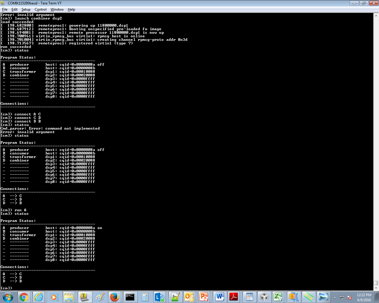

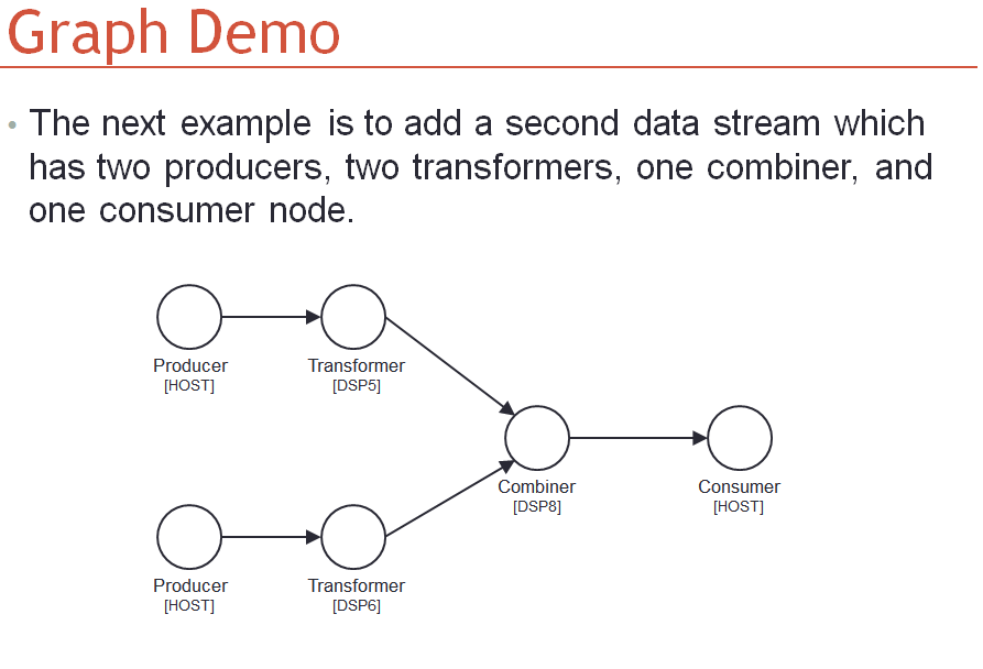

  • Does it have DSP-DSP communication too?
  • Hi Rao,
    In example, ex46_graph, combinations such as ARM-DSP0, DSP0-DSP1, DSP-ARM and lot more combinations are demonstrated as a Producer-combiner-transformer-consumer
    In this example, you can use any DSP cores and communicated between DSP- DSP, DSP-ARM, ARM-DSP etc.
    These are the combinations I tried and it worked for me.
    I have attached the steps on how to run this example on the target. For compiling this example, you can refer to the readme.txt enclosed insise the package./cfs-file/__key/communityserver-discussions-components-files/791/6505.ex46_5F00_log.txt
