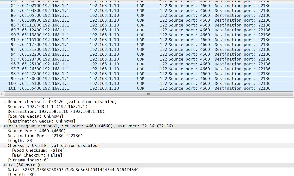

Hi everyone,
I'am using MSDK 2.1.2.6, custom board with C6670 processor.
This post is related to my previous one.
My gues is that I'am having problems with Packet accelerator setup. If we go back and look into pdk_C6670_1_1_2_6\packages\ti\drv\pa\example\emacExample\ cppi_qmss_mgmt.c file, we can find a CycleDelay (10000) line (#753) in the SendPacket() function. What does that delay stends for? I know that comment said "Give PA some time", but what exactly is PA doing at this time? How does PA determine the type of CRC polynom he supoosed to use if none was specified during setup?
The reason I'am asking is following: If I will remove completely this delay and DSP will keep pushing packets one by one the PA starting to generate wrong CRC. You can find screenshot 1.tif from Wireshark.  Packet numer 2 is a comand from Host application to DSP (CRC generated by network card so it's the case of CRC offload). 3rd packet is a response from DSP. Due to it's small length Everything is fine. But strating from packet number 7 when DSP transmitting large data packets the PA generating wrong CRC and this packets discarded by the Host application. The last one 22 packet has a correct generated CRC, as I see it bacause PA was not interrupted some time by the DSP and has enough time, like in the case of Delay.
After this I have increased Delay to CycleDelay (8000), but still not 10000 as it was before. The result you can find on the Screenshot 2.tif. In that case wrong CRC calculation apper randomly. It could fail on 74th big packet, or it can be on 200 packet. Everytime before pushing packet into PA queue, I'am checking Qmss_getQueueEntryCount(gvTxQ[8]) for 644 queue and number of entry count is always 0, so no packets truncated in the queue.
So as i understand the PA should be a pipeline device and if it can handle taking out packets out of queue is should handle the CRC  calculation properly. Any idea for the reason of such behavior?
1.tif2.tif

  • Pavlo,
    I need to reproduce the case that Tx queue is not full but CRC is wrong and investigate.
    Regards, Eric
  • Pavlo,
    I am trying with MCSDK 2.1.2.6 PA-EMAC example, with loopback mode to CPSW_LOOPBACK_NONE. If I totally remove the cycleDelay() in the Tx, there were packet loss as we discussed early.
    In the routine, hard-coded pktMatch[] was sent out, with fixed IP and UDP checksum, see attached picture. How did you use the PA to calculate the checksum and fill-into the packets before sending out?
    Regards, Eric
  • Eric,
    I replace the standard pktMatch[] with UDP packet composer function. Actually this is the code which we are using in our project. I have modified the pdk_C6670_1_1_2_6\packages\ti\drv\pa\example\emacExample\ cppi_qmss_mgmt.c file and cpsw_singlecore.c with required functions, so please, replace it in your project and we will be able to synchronize our projects for better communication. When I made this modifications I also do not observe any CRC degradation, which is very strange for me, since config and sending part are almost identical. So pictures from the head of the topic was made in our custom project. But when I modify the example project in the same way, I can't replicate the CRC problem.
    Anyway without Delay packets are still remain missing on the Host side for some reason.

  • Pavlo,
    For the wrong CRC issue:
    • you mentioned that can't be reproduced by changing TI reference project
    • the checksum is generated by udp_compose/inet_chksum/inet_chksum_pseudo functions, it is pure SW application to generate it
    • So this is not a real issue for PA
    For lost packet without delay issue:
    • This is known issue and need to track the TxQ[8] doesn't get full
    • Do you observe the same? Or there are still packet losses even queue is not full?
    Regards, Eric
    Eric, with quoted above, do you mean that there always should be some free room in TxQ, never allow the queue to fill up even if it does not over flow, just fill up? Could you please point us to some more reading about that? Thanks.
  • Eric,
    I'am sorry for a delay, but I need to figure everything out for myself before posting something.
    I have found the problem in our software. Wrong checksum generation was caused by free of  software pre allocated queue right after Qmss_queuePush () function. I think it's because we are using Host descriptors. The first question: Is it possible to solve that problem with using of Monolithic descriptors instead?
    Now we have created some static two dimension buffers, where one dimension is number of TX descriptors and second one is Ethernet frame length (1518). So when the packet is ready it copied into  there "RX" buffers and they are specified as source for Cppi_setData () and etc. functions. Also I now we are performing push only if Qmss_getQueueEntryCount(gPaTxQHnd[8]) !=0. So at first I thought that queue overflow is impossible.
    But then after some experimentation I have found out that after push getQueueEntryCount becomes 1,but at the same moment when PA take the descriptor from the queue it goes down to 0. And if we make free when getQueueEntryCount == 0 we will still had a wrong checksum generation. On Debug mode with 0 optimization and Ethernet transfer speed ~320 Mbps everything is ok and no data loss is observed. But when we go to release and speed rise up to ~450-500 Mbps the same problems happens (wrong checksum generation). Second question: does PA has it's own internal pipeline or queue which can overflow?
    And Third one: Please could you share some link on the known issue about  TxQ[8] queue overflow?
    Pavlo!
