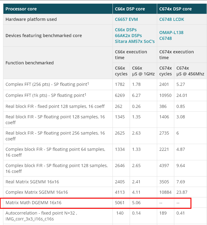

Hi experts,
Customer want to compare C66x and C674x performance on double precision fp algorithm. From this table, we can't find matrix math DGEMM performance on C674x. Do you have any information on that? I suppose double precision performance should be same on C66x and C674x as the intrinsics are same.
Allen

    I believe, Matrix Math DGEMM is not applicable for C674x, so, TI have not published the benchmarks cycles and execution time for the same and thereby, the benchmarking projects for DGEMM are not available as part of the libraries. Also, it doesn't contain little endian ELF version of the projects which is used for benchmarking. May be, you could reproduce the other C674x core benchmarks as mentioned in Table 1
    http://www.ti.com/lit/an/sprac13/sprac13.pdf
    In case, if it is helpful for you, you could refer the basic linear algebra subprogram (BLAS) benchmarking for DGEMM as below:
    http://processors.wiki.ti.com/images/d/d2/LINALG_1_0_benchmark_BLAS.pdf

  • Indeed Sivaraj is correct. If you look at the documentations for DSPLIB for C66 and C674 you can see that C66 has many more Matrx functions (especially double precision)
