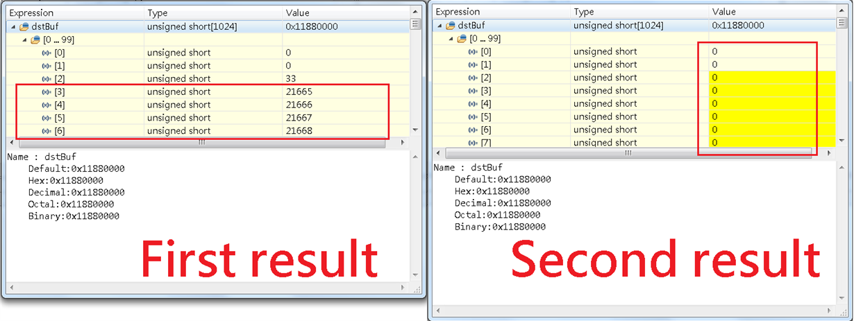

I'd like to use EDMA to control the McBSP without RTOS on C6657.
The McBSP is set to configure of the I2S and enable loop-back mode.
Now, I setup the channel 36 (Mcbsp0 RX) and channel 37 (Mcbsp0 TX) of EDMA.

Only first result (rx buffer) has non-zero value, others are zero value.
I need to reset the C6657 EVM board, and I can got this result again.
How to fix the problem? Thank you.

  • Hi Raja:
    My project run a loop for 10 times to do the EDMA.
    I use the loop-back mode of McBSP, and set the buffer of TX to 0x54A0~0x54AF.
    First result is happen at first power-on of EVM, and the RX buffer can receive 0x54A0~0x54AF.
    Second result is happen at otherwise (2nd~10th EDMA and re-load application). The RX buffer receives all zero data.
    Re-loading the application can't get the correct result (0x54A0~0x54AF).
    Until I power down the EVM and then power up the EVM, the program can just receive one time the correct result.
    Thank you for your prompt reply.
    Thanks for your post.
    In general, it is recommended to use McBSP LLD which is available in PDK C6657 1_1_2_6 of MCSDK 02_01_01_04 and the LLD is well documented and will be updated along with MCSDK package.
    Kinldy take a look at the "MCBSP_LLD_SDS.pdf" file in "~\ti\pdk_C6657_1_1_2_6\docs" folder and the McBSP digital loopback example can be found in "~\ti\pdk_C6657_1_1_2_6\packages\ti\drv\exampleProjects" folder. Please validate your configuration with the reference example code on McBSP0 framesync, clock on both Tx. and Rx.
    As well, please  find attached one example project to demonstrate the McBSP/EDMA setup. The attached has some McBSP CSL files which is ported from other device, not existing in the current C6657 PDK package. Kindly try with this and check whether the same issue occurs or not.
    /cfs-file/__key/communityserver-discussions-components-files/791/6366.7870.4555.McBSP_5F00_EDMA_5F00_example.zip
    Please also note the McBSP have both non-FIFO and FIFO modes, The DXR and DRR addresses are different in those modes. Please refer to the C6657 memory map table for details. The example code should show the difference as well.
