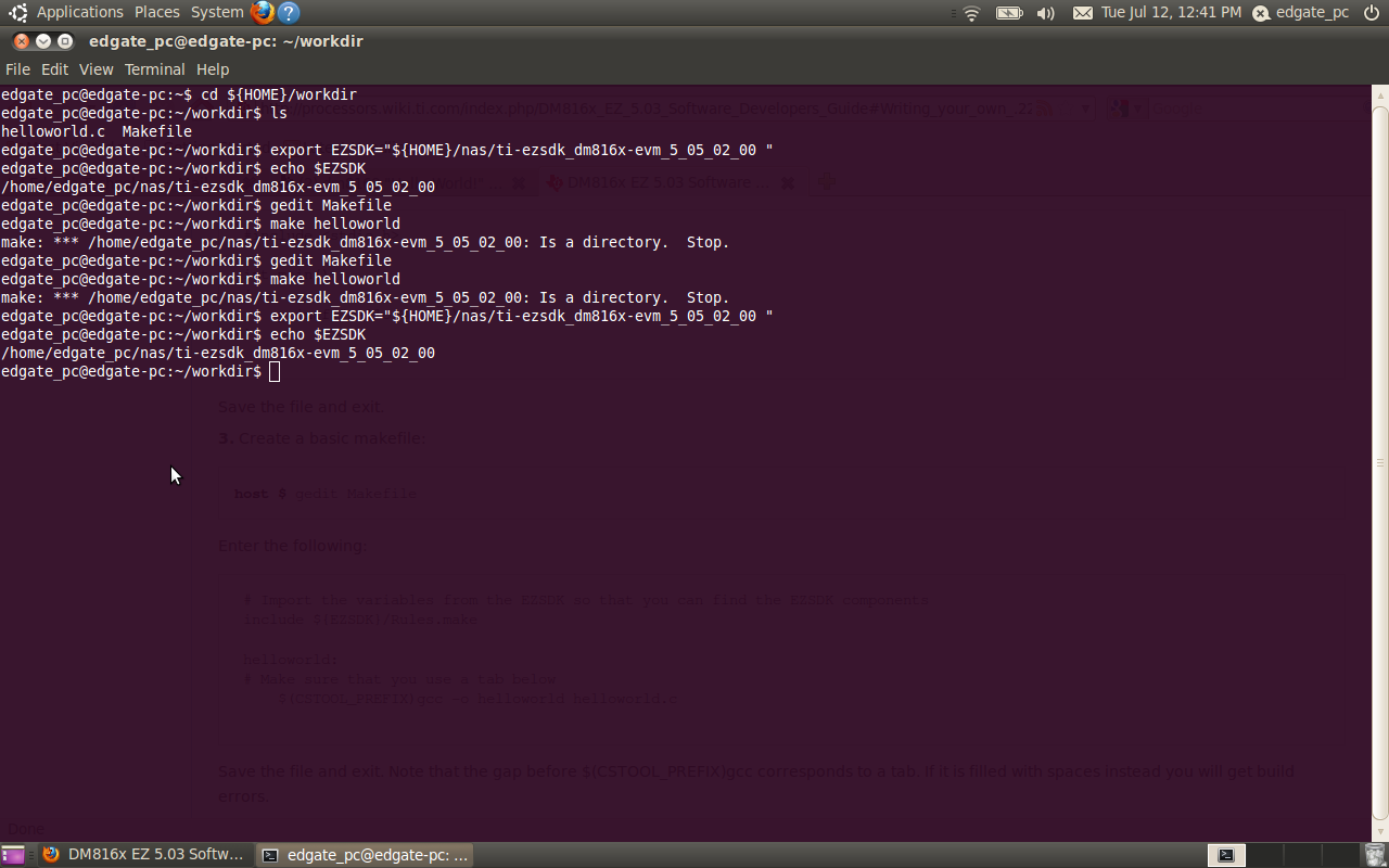

    Now i got the folder with the name
    "ti-ezsdk_dm816x-evm_5_05_02_00",earlier i installed as super user
    thats why i dint get.
    But i dint rename that folder name to "ezsdk" as it is not given in
    the pdf.instead they have given the step
    export EZSDK="${HOME}/ti-ezsdk_dm816x-evm_xx_xx_xx_xx",i did this
    .Because in Makefile they used the word EZSDK.
    i did the following steps,
    1)host $ mkdir ${HOME}/workdir
    host $ cd ${HOME}/workdir
    2)gedit helloworld.c
    3)#include <stdio.h>
    int main()
    printf("Hello World!\n");
    4)host $ gedit Makefile
    5)# Import the variables from the EZSDK so that you can find the EZSDK
    components
    include ${EZSDK}/Rules.make
    helloworld:
    # Make sure that you use a tab below
    $(CSTOOL_PREFIX)gcc -o helloworld helloworld.c
    6)echo $EZSDK
    7)make helloworld
    when i do this,i got errors like
    edgate_pc@edgate-pc:~/workdir$ make helloworld
    make: *** /home/edgate_pc/nas/ti-ezsdk_dm816x-evm_5_05_02_00: Is a
    directory. Stop.
    thank you.

  • Hi Pavel,
    I I have done TAB and did  export the EZSDK variable to the EZSDK path,it shows correct path after doing "echo $EZSDK".
    but still the same same problem.
    see the attachmmnet.
    thank you.

  • In Rules.make you have:
    # The installation directory of the SDK.
    EZSDK_INSTALL_DIR=/home/edgate_pc/ti-ezsdk_dm816x-evm_5_05_02_00
    While your install dir is:
    Can you try to fix the issue with editing the Rules.make file?
    EZSDK_INSTALL_DIR=/home/edgate_pc/nas/ti-ezsdk_dm816x-evm_5_05_02_00
  • Rules (1).rar
    HI Pavel,
    I changed but still the result is same..no ouput.see the file what am sending you.
    thank you
    waiting for your reply Pavel.
    thank you.
  • Looks like this inconsistency can not be corrected manually. I would suggest you to delete ti-ezsdk_dm816x-evm_5_05_02_00 folder and install again.
