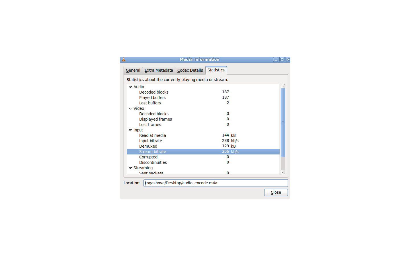

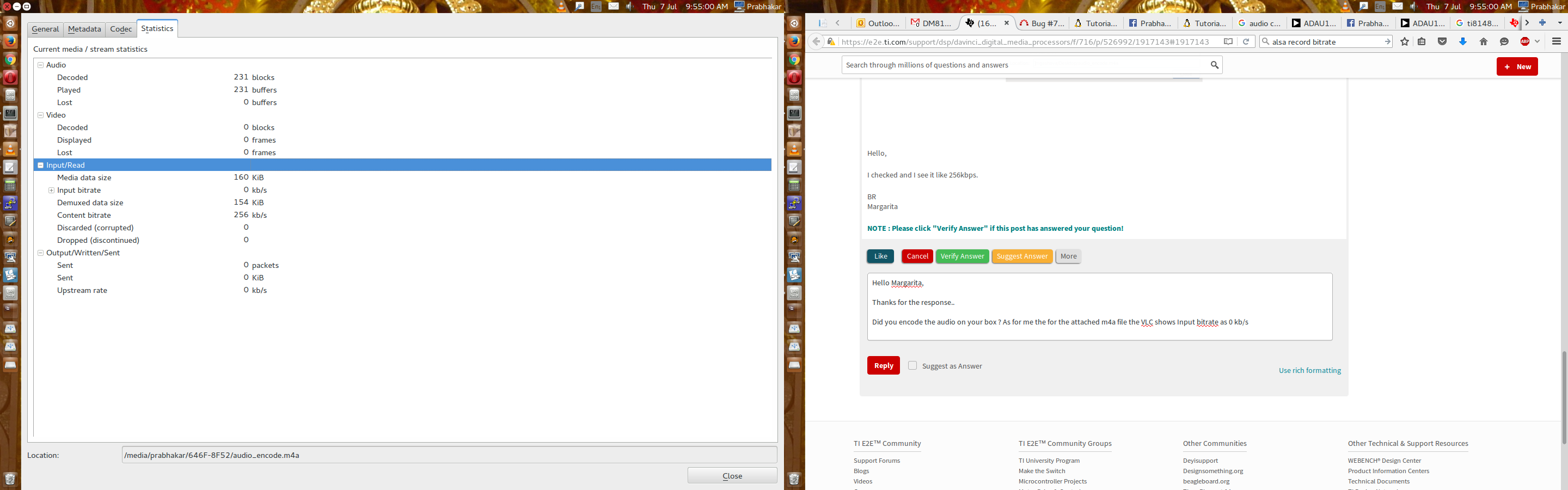

Now when I check the bitrate its variable:
prabhakar@tango-charlie:/media/prabhakar/646F-8F52$ mediainfo audio_encode.m4a
General
Complete name                            : audio_encode.m4a
Format                                   : ADTS
Format/Info                              : Audio Data Transport Stream
File size                                : 313 KiB
Overall bit rate mode                    : Variable
Audio
Format                                   : AAC
Format/Info                              : Advanced Audio Codec
Format version                           : Version 4
Format profile                           : LC
Bit rate mode                            : Variable
Channel(s)                               : 2 channels
Channel positions                        : Front: L R
Sampling rate                            : 48.0 KHz
Compression mode                         : Lossy
Stream size                              : 313 KiB (100%)
When I right click and see the properties and see Bitrate: N/A
Because of this some of the swf players are not able to play this audio.
Is there something in encoder which can force the bitrate to be fixed and not variable ?
