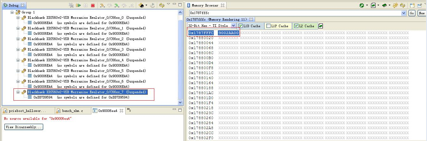

      I use C6678EVM ,pcie boot ,and I have some questions as following :
     After  I use linux PC transport the image of project to DDR,and linux PC would write boot entry address to core 0's magic address ,and core 0 can run as well.
    Then core 0 will write the entry address to core 1.....7's magic address ,the code I use as following :
if(DNUM==0)
		for (core = 1; core < 8; core++)
			if(DEVICE_REG32_R(BOOT_MAGIC_ADDR(core))==0)
	                   DEVICE_REG32_W(BOOT_MAGIC_ADDR(core), (uint32_t)&_c_int00);
      And core 1....6 can run as well after core 0 execute above code ,but core 7 can't ,I have checked it after connect CCS,you can see the picture as following :
      core 7 isn't execute the code in the value of magic address (boot entry address 0x9002AA00),why ?

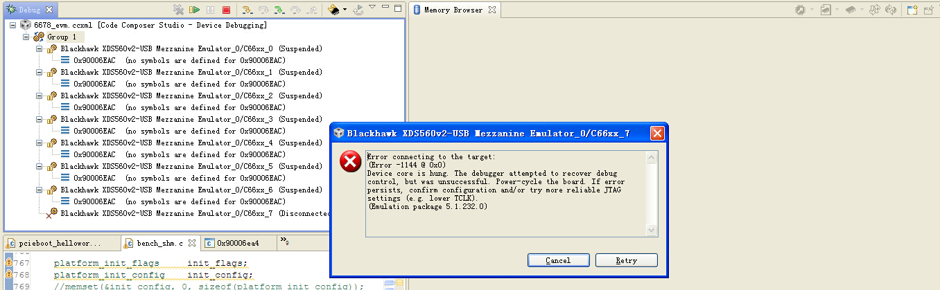

  • Hi,Raja,
        As you said ,I have added the delay function and the code as following :
    	if(DNUM==0)
    		platform_delay(1000);
            and core 7 can't connect CCS:
    Simon
