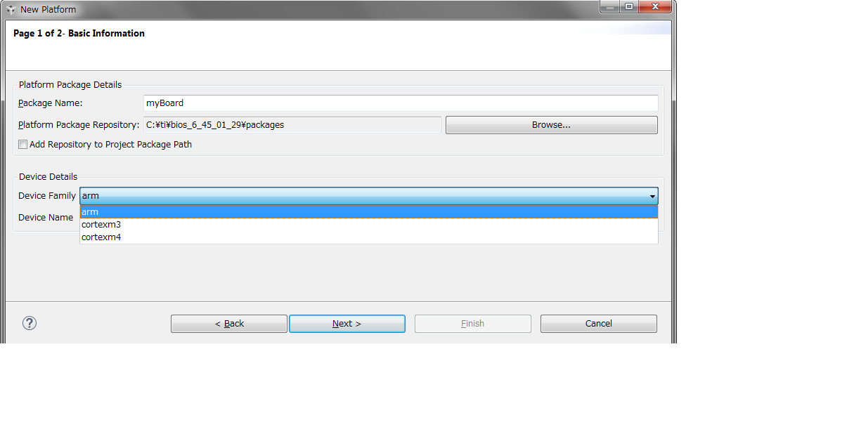

[CCSv6.1.2] Creating platform for DSP
When I use CCSv6.1.2, I can't create platform for DSP because there is no list for dsp. The wizard shows only arm lists in device family.
Please note I'm using  bios_6_45_01_29 as a platform repository and it actually contains K2G platform, which it is the platform I want to use as baseline.
C:\ti\bios_6_45_01_29\packages\ti\platforms\evmTCI66AK2G02
Any suggestion ?
Naoki
  • Naoki,
    I believe you need to set you CCS Preferences before you launch the Platform Wizard. Here is what I tried.
    CCS > Window Preferences
    Code Composer Studio > RTSC > Products
    Install New... > Select bios_6_45_01_29
    OK
    Restart CCS
    XDCtools version: 3.32.0.06_core
    Products and Repositories > SYS/BIOS 6.45.1.29 > Select
    Device family: C6000
    OK
    CCS Debug Perspective
    Tools > RTSC Tools > Platform > New
    Package Name: TCI66AK2G02_DSP0
    Device Family: c6000
    Device Name: TCI66AK2G02
    I'm guessing it's the CCS Preference settings that you are missing.
    ~Ramsey
  • Ok, by following your suggestions, I succeeded to create my custom platform. Thank you very much for your help, Ramsey.
    Naoki
