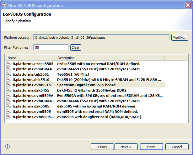

    Simply put, when someone wants to create a new DSP/BIOS configuration out from scratch, there is no available option as a platform for any C5515 (eZdsp,evm,dsk,etc) only for 5505.
    When we do right-click on project->New->DSP/BIOS v5.xx configuration file
    then in the next platform selection screen there is no available option for any C5515.

    The platform definitions are now completely "owned" by xdctools, i.e. they are not part of BIOS 5.4x.  As Tom mentions, xdctools 3.16.03.36 has support for evm5515.  When creating your configuration simply click the "Modify" button and point to the xdctools_3_16_03_36 directory as I show below:
    Then you will have an option for evm5515.

  • Thanks for the hint.
    I've manually downloaded xdctools_3_20_00_41, installed it and now it displays a evm5515.
    Yet there is no eZdsp5515 (which is the board we use here) even on this latest version of xdctools.

  • We don't always make an official "platform" for every single board.  There's no need.  Just use evm5515 and if there's a difference in the amount of external memory you can make that change in your tcf.
    If you really want to make your own platform this is something you can do on your own.  The procedure is documented in Chapter 4.2 "Creating Custom Platform Files" of the TCONF User's Guide.

  • Christos,
    The eZdsp5515 will be added to the tools release, but isn't the highest priority at the moment.  As Brad mentioned you can create a DSP/BIOS project for the eZdsp5515 by specifying the evm5515 and then modifying the external memory map.  From BIOS perspective that is the only difference between the targets.  The evm5515 configuration is available starting with DSP/BIOS 5.41.03.17 and XDC Tools 3.16.03.36.
    If you really want to have a ezdsp5515 configuration now and not wait until it is released in DSP/BIOS and XDC Tools, then you can do the following:
    1. Go to folder C:\Program Files\Texas Instruments\xdctools_3_16_03_36\packages\ti\platforms\ (default location).
    2. Create folder named \ezdsp5515.
    3. Go to folder \evm5515 in the same \platforms folder and copy Platform.tci to your newly created \ezdsp5515 folder.
    4. Open \ezdsp5515\Platform.tci file in a text editor.
    5. Find the line: * !DESCRIPTION 55XX!  Spectrum Digital evm5515 board.  and change it to: * !DESCRIPTION 55XX!  Spectrum Digital eZdsp5515 USB Stick.
    6. Find the line: * !NAME! ti.platforms.evm5515 and change it to: * !NAME! ti.platforms.ezdsp5515.  The name is critical, so make sure this is accurate.
    7. Find the line: mem_ext[1] =.  This begins the description of the external memories available on the EVM which are not available on the eZdsp Stick.
    8. Delete the two structures mem_ext[1] and mem_ext[2] so that the external memory definition now matches the target you want to use.
    9. Find the line: *  @(#) ti.platforms.evm5515; 1, 0, 0,6; 2-23-2010 16:59:30; /db/ztree/library/trees/platform/platform-k32x/src/.
    10. Change ti.platforms.evm5515 to ti.platforms.ezdsp5515.
    11. Save the modified Platform.tci file.
    This completes the creation of the ezdsp5515 definition and you can now create a BIOS project  in CCSv4.  When you go to create your BIOS configuration file you will need to specify the \platforms folder where you created the ezdsp5515 definition.  Also to build correctly you need to do the following in CCSv4:
