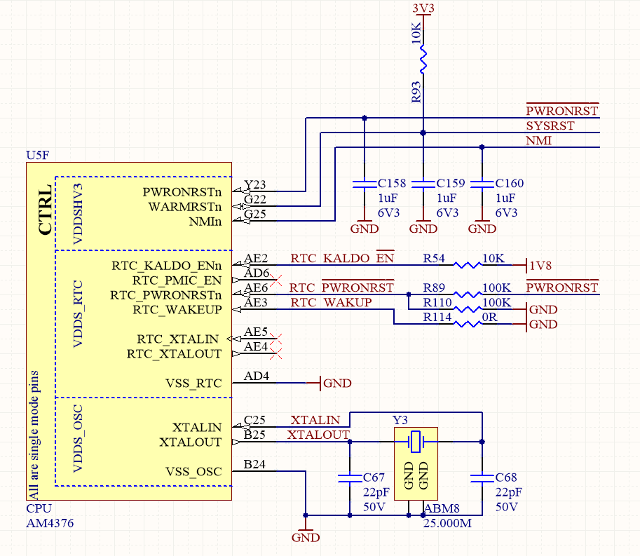

AM437x simplified power sequencing and RTC
Other Parts Discussed in Thread: TPS65218, AM4376
I want to have the possibility to use RTC functionality while powered if needed.
I aim at figure 4.7 power sequencing
Here is my design
On TPS65218:
Pin 20..25 and 27 are grounded
Pin 18, 19 and 40 are left unconnected
On AM4376:
F8 (VDDA3P3_IOLDO) is grounded
AD3 (CAP_VDD_RTC) is powered by VDD_CORE
E23 (VDDS_CLKOUT) and AD5 (VDDS_RTC) are powered by 1V8 (LDO1)
AE2 (RTC_KALDO_ENn) is connected to 1V8 (LDO1)
AD6 (RTC_PMIC_EN),AE3 RTC_WAKEUP), AE5 and AE4 (RTC_XTAL IN/OUT) are left unconnected
AE6 (RTC_PWRONRSTn) can be selectively connected to GROUND or to 1V8 (LDO1) with O Ohms resistor in order to enable or disable RTC core
Is that implementation correct?
