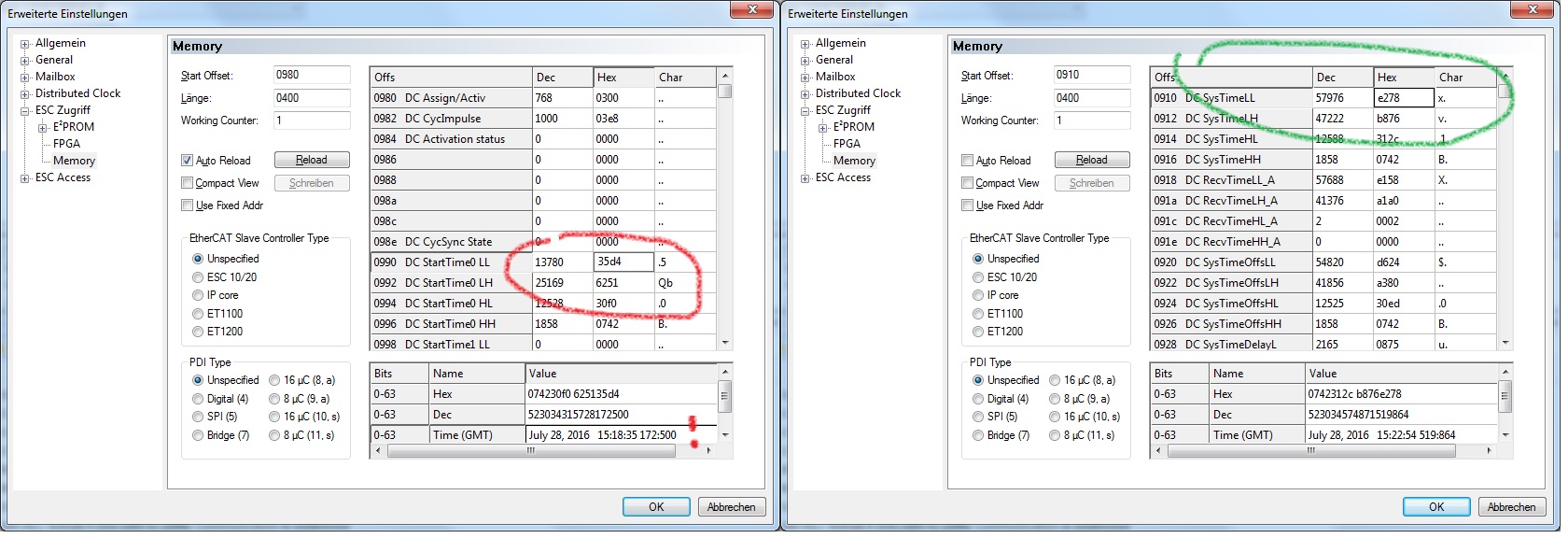

    - the large floating DCCtrlError values are now gone. The DCCtrlError shows now good smal values.
    - but at the 'bad' controler, which is not generating Sync0 pulses, the registers 0x0990:0x0992 (DC StartTime0 L) are showing a frozen value, while the 'good' controlers are showing changing values at these registers!! Thats the difference in registers I've seen between good and bad ones.
    the well/good operating controler:
    the bad/wrong operating controler without Sync0 pulses:

  • PS:
    - I've detected the issue also at the first controler (dc reference clock master) as like at dc reference slaves.
    - The issue occures with 9000µs Sync0 period and also with 500µs period (same like pdo cycle time of 500µs).
    the screenshots are showing a controller with the issue (0x910:0x912 running sys time, 0x990:0x992 frozen DC StartTime0):
    If the issue occures, the DC StartTime0 register stands frozen and shows a Time near the init-time of OP/DC from TwinCAT. The DC SysTimeL is running with the actual time.
    At the other controlers without the issue, the DC StartTime0 register is a changing value with timevalues near the DC SysTimeL.
