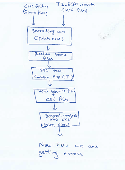

  • Hi paula
    We are using :-
    SDK = sysbios_ind_sdk_win32setup_02_01_01_02.exe
    SSC = SSC V5.11 (Tool 1.3.2)
    CCS= CCS6.1.3.00033_win32.zip
    Building EtherCAT Application using ETG Code Base and TI Patch file
    Downlaod EtherCAT stack (See release notes for version information) from ETG website and extract it to a local folder.
    Apply ( See Apply instructions below) TI_ECAT.patch file found at $(IA_SDK_HOME)\Protocols\ethercat_slave\ecat_appl\patch on extracted ETG stack code. Copy the entire files (.c and .h) to $(IA_SDK_HOME)\Protocols\ethercat_slave\ecat_appl\EcatStack
    Launch CCS and import ecat_appl project found at $(IA_SDK_HOME)\Protocols\ethercat_slave\ecat_appl to CCS
    Build the project. This will generate the application binary which can be used to run on AM335x.
    Applying a Patch file
    Download Windows Patch Utility from gnuwin32.sourceforge.net/.../patch-bin-zip.php . ( Note that this is not a TI tool - see savannah.gnu.org/.../ for more details and licensing information))
    Extract the zip file to the Windows PC. Patch file utility(Patch.exe) can be found in bin folder.
    Launch DOS Command prompt ( Start->Run->cmd).
    CD to bin folder.
    Execute patch.exe as given below
    patch.exe -i PATH_FILE -d SOURCE_DIR
    where PATCH_FILE is name of the patch file with full path and SOURCE_DIR is Directory with full path where source files are placed .
    we are following this method.
    Thanks and regards
    Chinmay Gupta

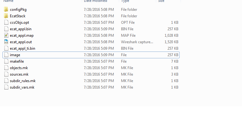

  • Hi paula
    C:\TI\sysbios_ind_sdk_2.1.1.2\sdk\examples\ethercat_slave .
    this project is working fine with some warnings but output is there .
    so the versions that I am using are all compatible .
    but this example don't have functionality for CoE or object dictionary .
    so to implement that I need to develop project by patching up the source files and doing the process that I have mentioned earlier that's where I am facing problem.
    Chinmay Gupta

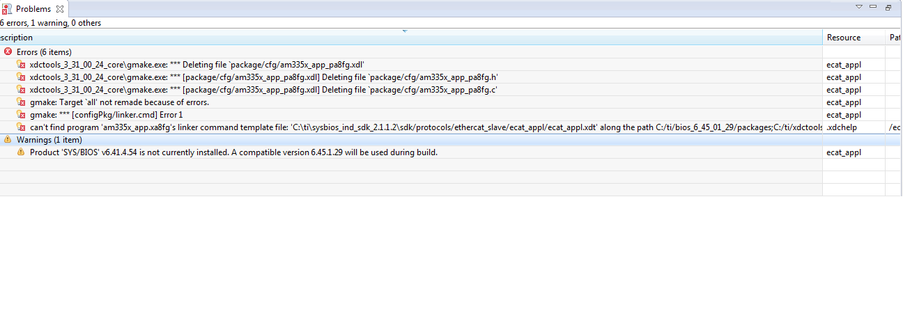

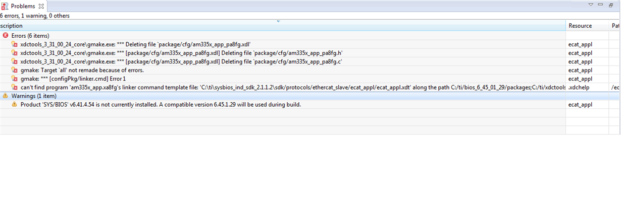

  • Hi Chinmay, no sure why ecat_def.h is not in your stack.. could you please add attached file to <installation_path_ISDK>\sdk\protocols\ethercat_slave\ecat_appl\EcatStack and give a try?ecat_def.h
    thank you,
    Paula

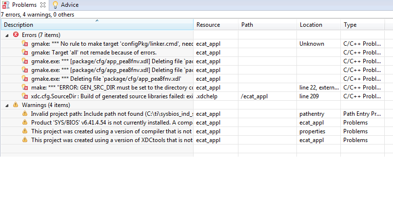

  • Hi Paula,
    was able to rectify that error , that was because of path address .
    came up with many more errors solved them by changing the path only.
    now I am struck on these errors .
    Console screen :-
    **** Build of configuration am437x_debug for project ecat_appl ****
    "C:\\ti\\ccsv6\\utils\\bin\\gmake" -k all
    'Building file: ../am437x_app.cfg'
    'Invoking: XDCtools'
    "C:/ti/xdctools_3_31_00_24_core/xs" --xdcpath="C:/ti/bios_6_45_01_29/packages;" xdc.tools.configuro -o configPkg -t gnu.targets.arm.A9F -p ti.platforms.evmAM437X -r debug -c "C:/ti/ccsv6/tools/compiler/gcc-arm-none-eabi-4_8-2014q3" "../am437x_app.cfg"
    making package.mak (because of package.bld) ...
    generating interfaces for package configPkg (because package/package.xdc.inc is older than package.xdc) ...
    configuring am437x_app.xa9fg from package/cfg/am437x_app_pa9fg.cfg ...
    generating custom ti.sysbios library makefile ...
    Starting build of library sources ...
    making C:/ti/sysbios_ind_sdk_02.01.02.02/sdk/protocols/ethercat_slave/ecat_appl/src/sysbios/sysbios.aa9fg ...
    gmake[1]: Entering directory `C:/ti/sysbios_ind_sdk_02.01.02.02/sdk/protocols/ethercat_slave/ecat_appl/src/sysbios'
    gmake[1]: Nothing to be done for `all'.
    gmake[1]: Leaving directory `C:/ti/sysbios_ind_sdk_02.01.02.02/sdk/protocols/ethercat_slave/ecat_appl/src/sysbios'
    Build of libraries done.
    cla9fg package/cfg/am437x_app_pa9fg.c ...
    'Finished building: ../am437x_app.cfg'
    'Building file: C:/ti/sysbios_ind_sdk_02.01.02.02/sdk/control/foc/adc.c'
    'Invoking: GNU Compiler'
    "C:/ti/ccsv6/tools/compiler/gcc-arm-none-eabi-4_8-2014q3/bin/arm-none-eabi-gcc.exe" -c -mcpu=cortex-a9 -mtune=cortex-a9 -marm -mfloat-abi=hard -mfpu=neon -Dam4379 -DAM43XX_FAMILY_BUILD -DNO_UART_MSG_APP -I"C:/ti/ccsv6/tools/compiler/gcc-arm-none-eabi-4_8-2014q3/arm-none-eabi/include" -I"C:/ti/2.2.1/sysbios_ind_sdk_02.01.02.02/sdk/control/foc/" -I"C:/ti/2.2.1/sysbios_ind_sdk_02.01.02.02/sdk/control/math_blocks" -I"C:/ti/sysbios_ind_sdk_02.01.02.02/sdk/protocols/ethercat_slave/ecat_appl/EcatStack" -I"C:/ti/2.2.1/sysbios_ind_sdk_02.01.02.02/sdk/starterware/include/" -I"C:/ti/2.2.1/sysbios_ind_sdk_02.01.02.02/sdk/starterware/include/utils" -I"C:/ti/2.2.1/sysbios_ind_sdk_02.01.02.02/sdk/starterware/include/hw" -I"C:/ti/2.2.1/sysbios_ind_sdk_02.01.02.02/sdk/starterware/include/am43xx/" -I"C:/ti/2.2.1/sysbios_ind_sdk_02.01.02.02/sdk/starterware/include/am43xx/am437x" -I"C:/ti/2.2.1/sysbios_ind_sdk_02.01.02.02/sdk/board/include" -I"C:/ti/2.2.1/sysbios_ind_sdk_02.01.02.02/sdk/board/include/idkAM437x" -I"C:/ti/2.2.1/sysbios_ind_sdk_02.01.02.02/sdk/os_drivers/include" -I"C:/ti/2.2.1/sysbios_ind_sdk_02.01.02.02/sdk/os_drivers/lld/pruss" -I"C:/ti/2.2.1/sysbios_ind_sdk_02.01.02.02/sdk/protocols/ethercat_slave/firmware/v2.0" -I"C:/ti/2.2.1/sysbios_ind_sdk_02.01.02.02/sdk/interfaces/endat_master/firmware" -I"C:/ti/2.2.1/sysbios_ind_sdk_02.01.02.02/sdk/interfaces/endat_master/include" -I"C:/ti/2.2.1/sysbios_ind_sdk_02.01.02.02/sdk/interfaces/pru_onchip_adc_sampling/firmware" -I"C:/ti/2.2.1/sysbios_ind_sdk_02.01.02.02/sdk/interfaces/sddf/firmware" -I"C:/ti/2.2.1/sysbios_ind_sdk_02.01.02.02/sdk/interfaces/sddf/include" -I"C:/ti/2.2.1/sysbios_ind_sdk_02.01.02.02/sdk/protocols/ethercat_slave/include" -I"C:/ti/2.2.1/sysbios_ind_sdk_02.01.02.02/sdk/starterware/library/qspilib/include" -I"C:/ti/2.2.1/sysbios_ind_sdk_02.01.02.02/sdk/starterware/device/" -g -gstrict-dwarf -Wall -MMD -MP -MF"foc/adc.d" -MT"foc/adc.d" -o"foc/adc.o" @"configPkg/compiler.opt" "C:/ti/sysbios_ind_sdk_02.01.02.02/sdk/control/foc/adc.c"

  • Hi
    Please check these errors .
    can't find program AM335x_app.xarfg's linker .....
    this error is causing problem .
    please tell me what to do ?
