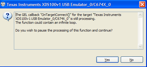

I'm straggling with the initialization of DDR2 (Micron MT47H32M16, 8 Meg x 16 x 4 banks).
My environment is C6748 @ 300MHz, the DDR2 is 400MHz capable, and so I'm trying to configure the DSP DDR controller to 150MHz (the controller's maximum).
There are multiple problems…..
First, the TI DSP DDR2 documentation (sprugj4.pdf) indicates an initialization flow which its sequence is quite different from the one which the LogicPD (EVK) example uses.
There is also a WiKi (http://processors.wiki.ti.com/index.php/Programming_mDDR/DDR2_EMIF_on_OMAP-L1x/C674x) that includes nice spreadsheet that calculates the various DDR2 controller registers' values.
Nothing works.
I have access to the DDR2 (read and write) from the JTAG emulator, after loading one of the GEL (both cases below), but sometimes the verification fails, and always (if any section in the linker file has been allocated to reside on the DDR2) the program loading fails.
The LogicPD GEL usually runs without hangs, but it seems that either the timers or/and the refresh rate values are incorrect. (Regardless if I use the spreadsheet values, or any other).
The second GEL, which includes sequence I wrote based on the TI DSP DDR2 documentation, halts (see below where), and beside doesn't improve the behavior of loading program which some of its sections are linked to reside on the DDR2.
Any idea?

    Eric Wilbur here. I have been using the C6748 EK for a few months now and consistently get "OnTargetConnect() not running atomically" error during connection to the target. I.e. it hangs. If you continue loading your code, the green Play button is greyed out because the GEL is stuck in an infinite loop in the mDDR init section. If I terminate debug, then relaunch the debugger, most of the time the program loads. This problem is consistent enough to be more than an instability - more like a bug.
    I'm using the latest 6748 GEL file from LogicPD. Has anyone else experienced a problem like this? Has anyone created a "stable' C6748.gel file?
    Below is the "message". Also, when I load code after the GEL file runs correctly, I often get stuck at _c_int00 and the debugger is "running" already - never gets to main(). I'm not sure if the problems are related.
    Eric

  • Eric
    I believe the LogicPD Gel files do not have any issue. On this thread, Uri was trying to create a gel file sequence based on our mDDR/DDR2 userguide sequence (Section 2.13.2) which is currently incorrect.
    The sequence in the Logic PD GEL is fine, I am showing the partially truncated sequence from the logicPD c6748 gel file below
