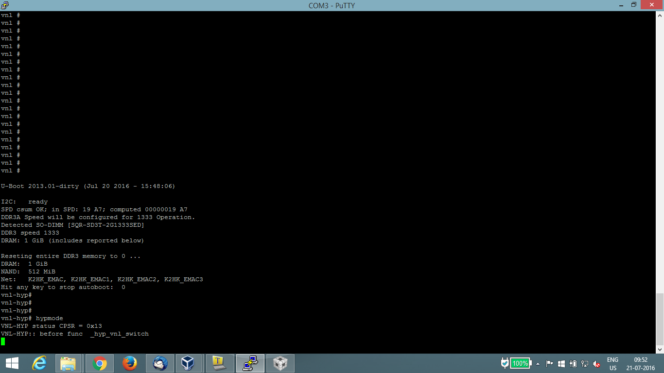

I have a Keystone II EVM (XTCIEVMK2X Rev 10) and I need to boot in hyp mode.
In order to support hyp mode i did following changes in current u-boot source.

Out put of modified u-boot prompt is captured as screen short
it seems it stuck in _hyp_vnl_switch
_hyp_vnl_switch:
mov r0, lr
mov r1, sp @ save SVC copy of LR and SP
isb
.byte 0x70, 0x00, 0x40, 0xe1 @ for newer hvc #0 || for older asm: .byte 0x70, 0x00, 0x40, 0xe1
mov sp, r1
mov lr, r0 @ restore SVC copy of LR and SP
bx lr
Can you please suggest what could be the possible Solution ???
Many Thanks,
Arun

  • Hi, Arun,
    TI development team is working on the HYP mode support and just got implemented on AM57x platforms. Due to the architecture difference, it is implemented in AM57x ROM code, but in KS2, it will be in boot monitor. In case you can't wait for KS2 implementation, here is a sample code from AM57x to eanble HYP mode as a reference.
