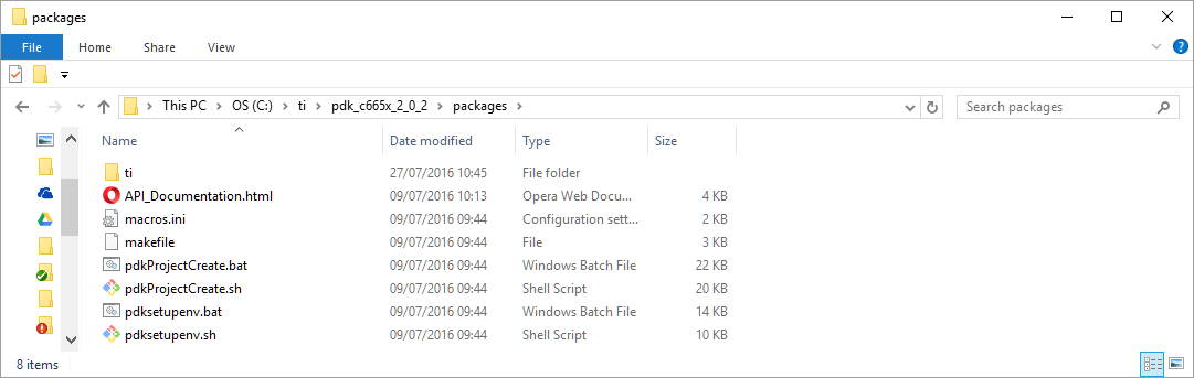

  • Hi Titus,
    Thanks for the reference, but I couldn't find the folder specified, All I have is:
    Another question in that regard:
    Does a code that the main function doesn't have BIOS_start, but rather have BIOS_exit(0) instead this is taken from the "HelloWorld" example project in CCS_5.
    It states the following:
    * normal BIOS programs, would call BIOS_start() to enable interrupts
    * and start the scheduler and kick BIOS into gear. But, this program
    * is a simple sanity test and calls BIOS_exit() instead.
    Creates a task or not for that scenario?
  • I think, you have referred this.
    C:\ti\bios_6_41_04_54\packages\ti\sysbios\examples\generic\hello\hello.c
    In this example, it doesn't create any tasks or no BIOS related stuff, so its using "Bios_exit" in main().
    Edited:
    When you call Bios_start(), it would run the "tasks" as per the priority which you have created in *.cfg or main() before "Bios_start()"
    You have to run the "pdkProjectCreate.bat" script to create the example projects.
    Refer to this wiki page.
    processors.wiki.ti.com/.../Processor_SDK_-_Create_PDK_projects
